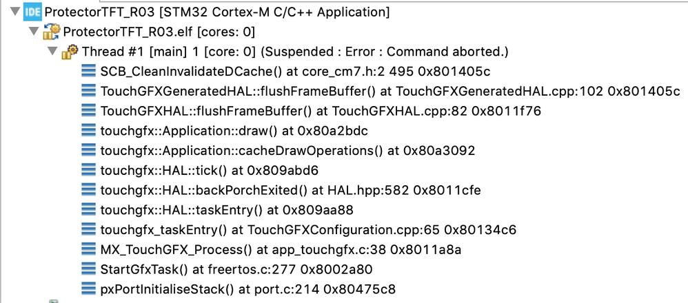

Just noticed that my application TouchGXF task hanged. Other FreeRTOS tasks are continue to work.
Debugger shows that problem is within core_cm7 SCB_CleanInvalidateDCache():

2022-01-20 11:06 PM
Task stack:

1) call SCB_InvalidateDCache() from TouchGFXGeneratedHAL::flushFrameBuffer() - this is an original functions where I did catch this bug - gives screen artifacts and hungs in the middle of nowhere.
2) call SCB_InvalidateDCache() from TouchGFXGeneratedHAL::InvalidateCache() leads to MemFault right before first screen should be painted.
