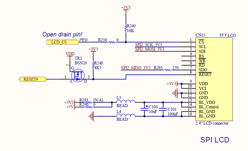

Hello @CJaid.1 ,
240x320 TFT color LCD connected to the SPI interface.(user manual : UM1807 section 2.20 Display and input devices)
You can refer to this link. It contains lcd libraries.
Foued

Hello.
Yes, I have the BSP and the user manual, but there is not much data about the LCD and what is the part name/ model number of the lcd so that i can use the respective bsp file.
Also, are there any sample programs where i can get some examples.
2023-03-21 9:05 AM
It's a 240x320 TFT LCD with SPI.
