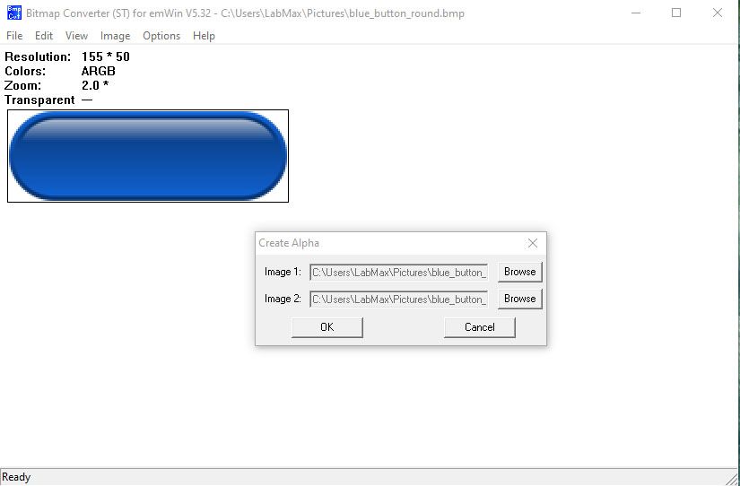

After spending a few days researching I found this program Bitmap Converter (ST) for emWin V5.32 in comes from ST in this package STemWin_Library_V1.2.0
I have to do the Alpha (I choose for image 1 and 2 the same blue button) like on the picture then I get 32 bit ARGB format like this one
0xFF254888,
0xFF254888,
0xFF254888,
0xFF264989,
0xFF264989,
and it finally worked with this code CopyBuffer((uint32_t *)blue_button, (uint32_t *)LAYER0_ADDRESS, 240, 160, 155, 50);
I only have to create bitmat image in photoshop first and then open with this program and save as C file and all the 32 bit code is inside.

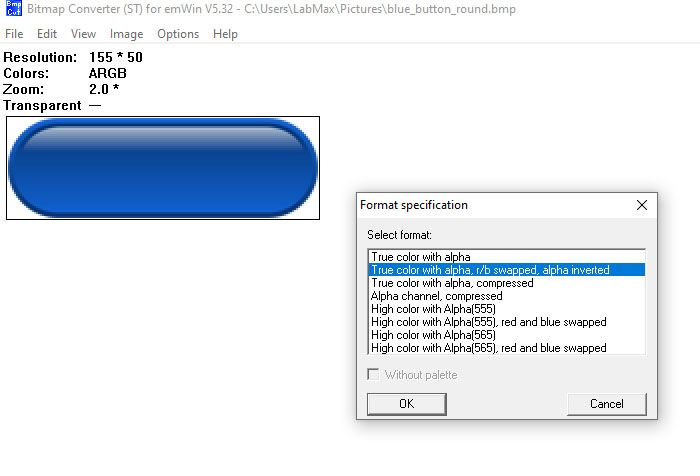

Hey I saw your video a while ago when I was researching, you got the red and blue inverted. Actually I got it first inverted too when I used Bitmap Converter (ST) for emWin V5.32
I had to choose option save as red and blue inverted with alpha, then I get the code right.

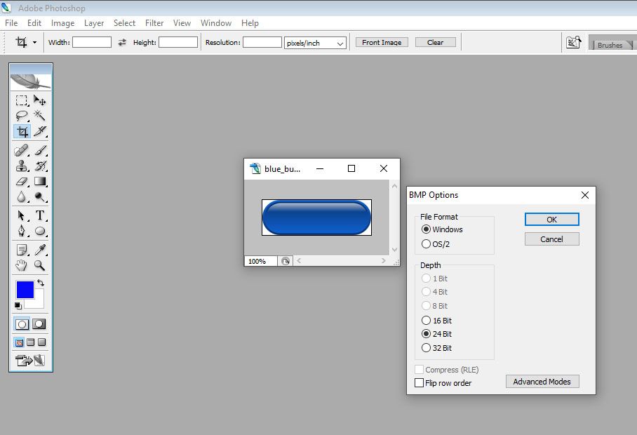

This function seems to take bmp image format as input.
You probably have to convert your image in .bmp (win bitmap) ARGB8888.
Or RGB888 RGB565, not raw format.
2020-08-24 7:53 AM

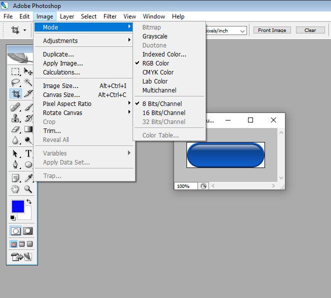

yes see the option I used in photoshop then I open it in Bitmap Converter (ST) for emWin V5.32v and save as red and blue inverted with alpha
