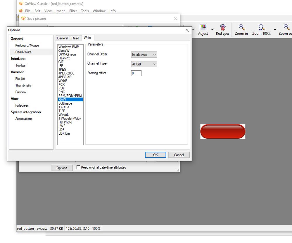

do you mean this program https://www.xnview.com/en/
I do not see the option to choose 32 bit but you can save raw data in ARGB

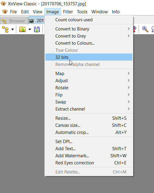

Yes Xnview image viewer.
HxD: https://mh-nexus.de/en/hxd/
32 bits pixel mode should be activated as per following image, I set it to set 0xFF as default alpha value, or you'll get 0 as default, I think.
2020-08-19 8:49 AM
you must have older version this option is not available in 2.49.3, there is nothing in options, properties, view to add extra tool bar

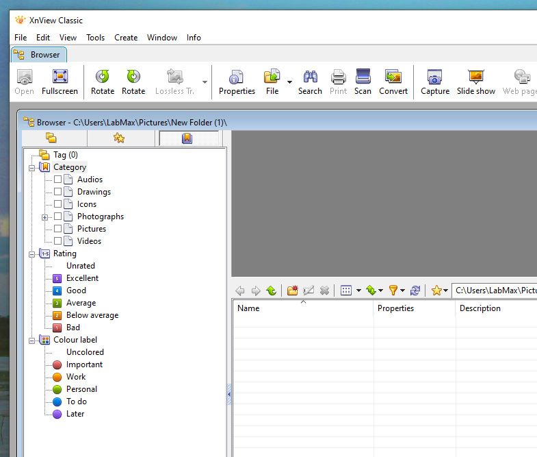

2020-08-20 1:34 AM
It is because you have not opened an image in the editor, you are showing the browser.
You have to click File=>Open and select a picture, or select one on the left in the browser.
The 32bits option appears only when a picture is opened.

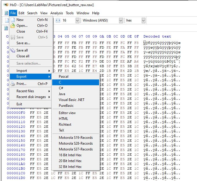

I did as instructed, I did the 32 bit image, then I open raw image in HxD export as C, and this is what i get
unsigned char rawData[31000] = {
0xFF, 0xFF, 0xF1, 0xFF, 0xFF, 0xFF, 0xFB, 0xFF, 0xFF, 0xFD, 0xFF, 0xFE,
0xFF, 0xFC, 0xFF, 0xF8, 0xFF, 0xFF, 0xFF, 0xF8, 0xFF, 0xFF, 0xFE, 0xFB,
0xFF, 0xFF, 0xFD, 0xFE, 0xFF, 0xFA, 0xFF, 0xFF, 0xFF, 0xF7, 0xF8, 0xFD,
it does not look like the from ST. the ST looks like 32 bit
