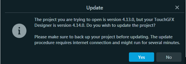

This was created after saying "Yes" to the following question:
I assume it is so one doesn't lose any modifications made to the framework or other files?
Do I need to maintain this directory?
2020-10-04 5:17 PM
If your project is working after updating to a new version, you can delete the backup directories. No need to maintain them :)

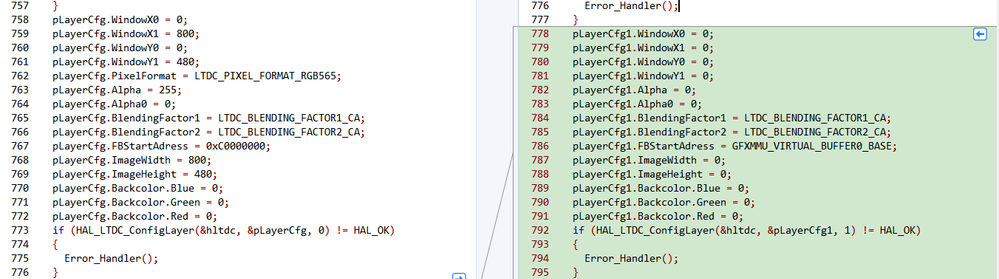

For example, I am also running Stm32CubeIDE 1.4.2. When doing a CubeMX Generate, I am now getting the following error that I never had before:
/Core/Src/main.c:786:30: error: 'GFXMMU_VIRTUAL_BUFFER0_BASE' undeclared (first use in this function)It is failing on the assigning of pLayerCfg1.FBStartAdress in the following lines of code...which didn't exit prior to this new install of CubeIDE and TouchGFX:

2020-10-06 5:58 AM
@Alexandre RENOUX
I am using my own hardware, so not an Application Template. The micro is an Stm32H743IIT.
Like I said, I was previously using Stm32CubeIDE 1.3.1 and TouchGFX 4.130. After using Stm32CubeIDE 1.4.2 and TouchGFX 4.14.0, this whole section was added to MX_LTDC_Init(), as seen in the difference below:
2020-10-06 5:55 PM
This is a bug from CubeMX that was reported and will be fixed for the next version of CubeMX (6.1 if I recall correctly).
