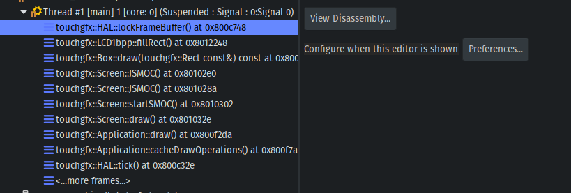

I've tried running this function in a timer:
extern "C"
void TouchGFX_Engine()
HAL::getInstance()->vSync();
OSWrappers::signalVSync();
}With no effect. Seems to be stuck at lockFrameBuffer()
I'm missing the concept of how the main loop is driven. Any ideas?
2021-02-01 10:07 PM
Found this thread: TouchGFX with SPI TFT and it appears that this bug has never been fixed.
2021-02-02 3:13 PM
Confirmed, works with double buffering, does not with a single buffer.
