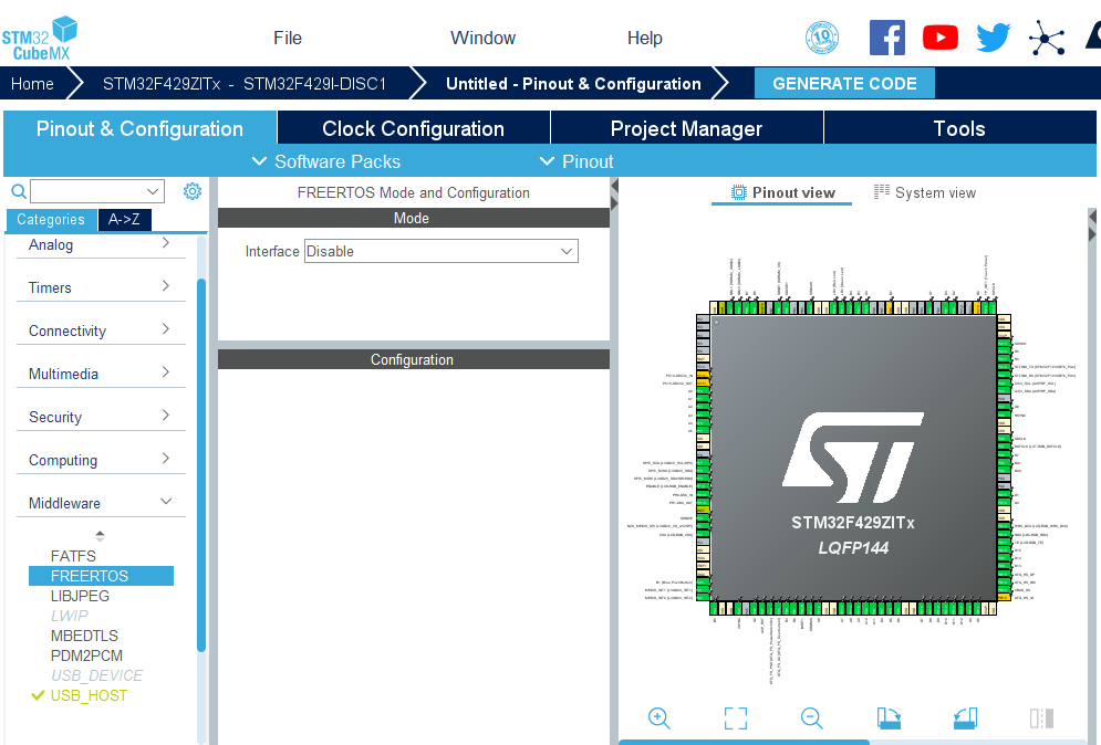

Since I'm just getting started, I would prefer to not use a RTOS for the time being if I can, even if it reduces the application's efficiency, but when I have configured the CubeMX that way, I camre across some errors.

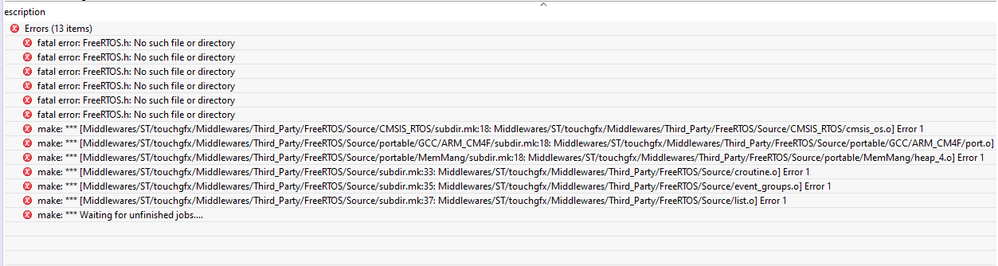

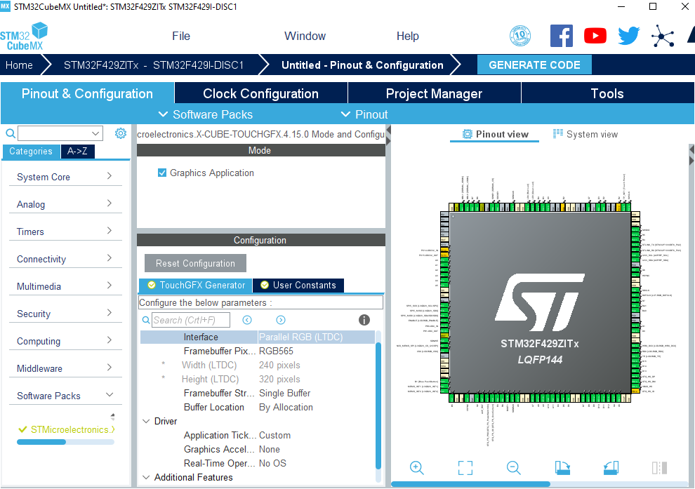

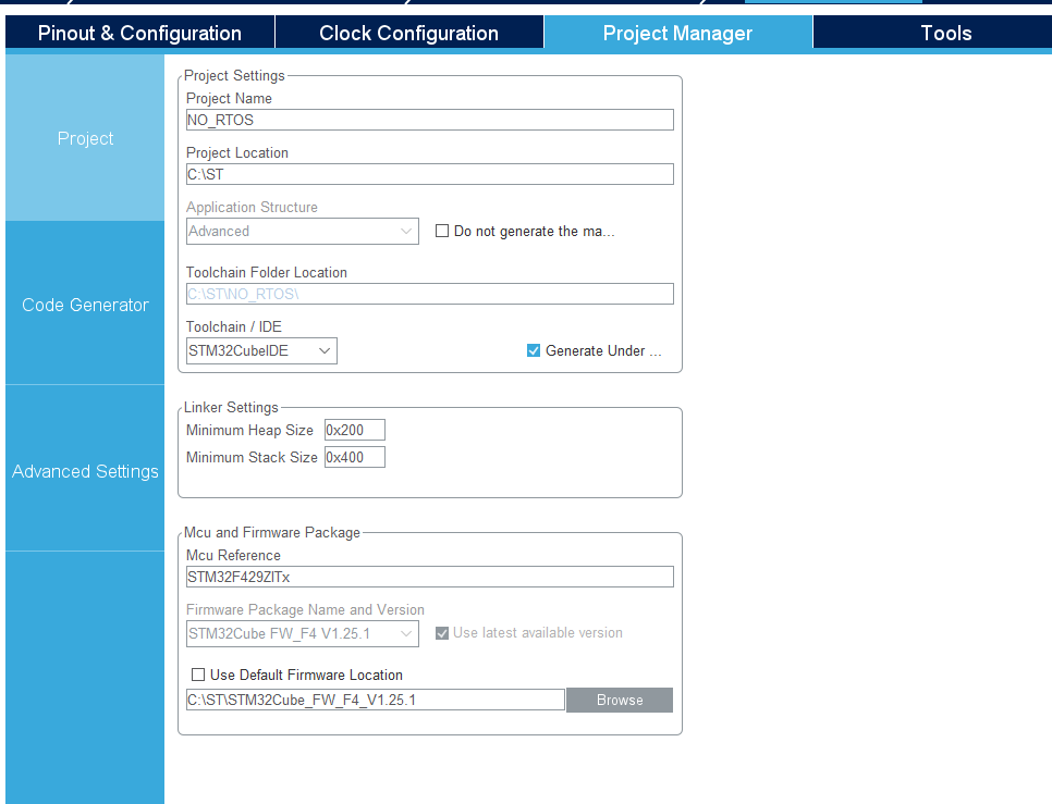

I will explain my procedure in case the problem is there. First, I have created a .ioc, configured it with a disabled FREERTOS and an activated Graphic Device (TouchGFX Designer) and generated the code. Then I modified the application in TouchGFX, have generated the code, imported it and programmed it in CubeIde and when I tried to build the project I found these errors.
I'm aware that, since there's no FREERTOS configured, it cannot find those files but commenting the code lines ends up in namespace and class reference errors. It's confusing because I configured the MX and therefore, TouchGFX application that way. Shouldn't it generate the files with no RTOS then?

Hi, sorry for the delay.
Definitely there should be no references in your project to FreeRTOS. Looks like the error is coming from within an embedde TouchGFX middlewares folder which may expect a FreeRTOS installation further out (which is correctly not there).

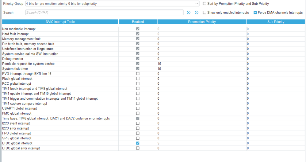

Thank You for the reply Romain, I start the tutorial from you link, and I've discovered that in LTDC_IRQHandle(), doesn't trigger. I have the interrupt activated from CubeMX for LTDC. I'm missing something but I don't know what. But If I start a project from TouchGFX Designer for STM32F429I_DISC1 it works, but the example is with RTOS, I don't know how to start a project in Designer without RTOS.

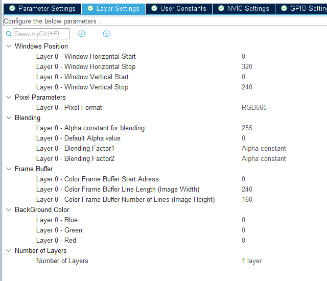

I've modified the Layer Settings to match the frame buffer size
