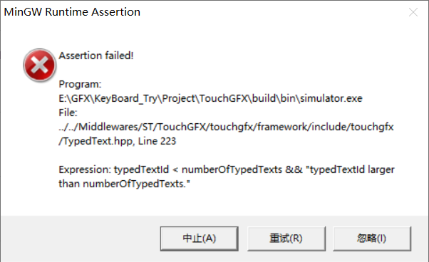

I want to creat my keyboard , but the problem arises.
I have to make it as close to the touchgfx example as possible, but the problem remained.
I'd appreciate your advice.
Thank you.
2020-03-31 8:15 AM
Looks like you're trying to reference an ID that doesn't exist. Can you try re-generating code?
/Martin
2020-03-31 8:15 AM
/Martin
2020-04-01 12:44 AM
Thank you very much for your advice.The problem was solved
