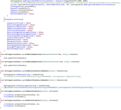

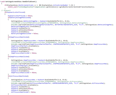

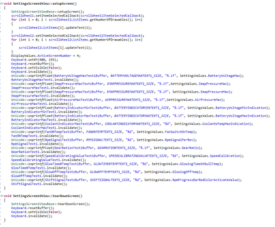

2024-04-18 10:28 AM
If I enter the page:
If I press enter, update value:

Yes, you're right! The if branch was executed more than once. I edited the code logic.
(with eeprom write and read are good too)
Already only one error, with keyboard only on two screens.
Keyboard Textarea ???
and on the other screen the letters
