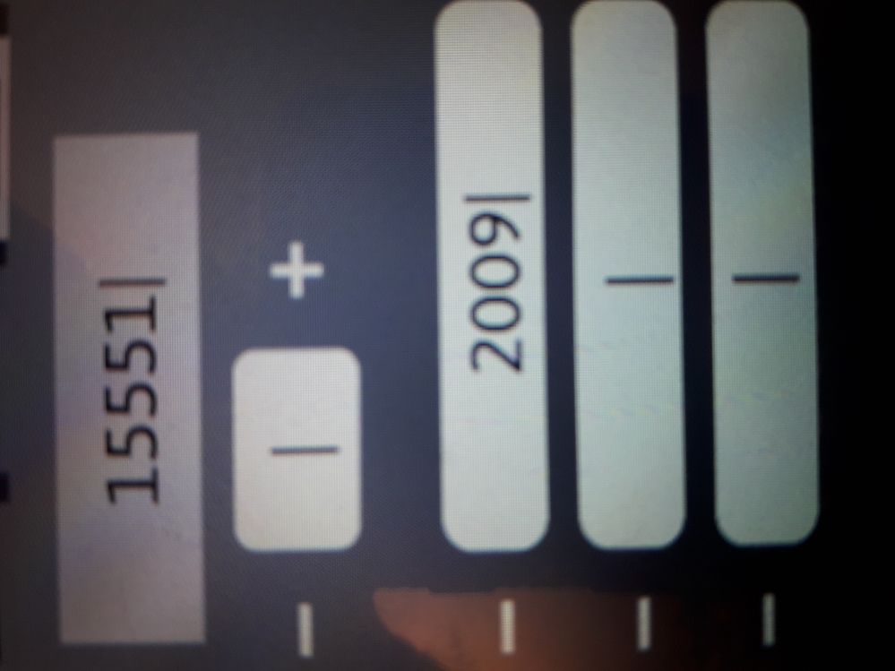

Weird artifact showing in my TextAreaWithOneWildcard
Sandy.Dahl
Associate II
Every text areas I place have cursor visible. From some of the areas I don't want to have cursors. How do I hide them?

Text areas in TouchGFX do not support cursors. Can you show me a screenshot? Something funky must be going on :)
/Martin
Hi Martin!
Interesting, them I'm probably doing it wrong. It looks like this:
Hi @Sandy.Dahl​,
That definitely looks "interesting" and actually does look like a cursor :) Are you able at all to share your project, or part of it, with me so that i can see this for myself and maybe debug it?

There's nothing in that code that looks suspicious at all.
Instead of Unicode::strncpy(MeasurementBuffer, Unicode::EMPTY, 1), could you try MeasurementBuffer[0] = 0 ?
/Martin
No change in outcome with your suggestion unfortunately... What to try now?
Hi Sandy, since i can't try this myself we can only speculate.To me it simply looks like the character "|". Can you check your buffers for that unicode? U+007C.
