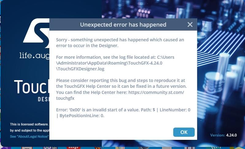

During the process of using the software, the error shown in the picture occurred. Please inform me of how to fix this problem.We would be most grateful.

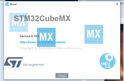

So update to the latest version of CubeMx V6.14.0
2025-03-03 6:23 AM - last edited on 2025-03-03 6:27 AM by mƎALLEm
I upgraded CubeMX, restarted the software and refreshed the resource pack, but there is still no option to install version 4.25.

I have tried uninstalling and reinstalling the Touchgfx V4.24.0 software several times, but none of them worked. There was always an error message displayed.
