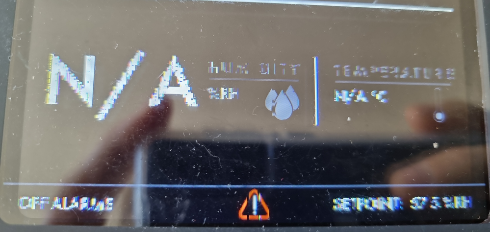

I am developing a TouchGFX application for my STM32H7 MCU using LTDC. Sometimes, after turning the system on, the assets on screen looks "smeared out". Or rather, it looks out of sync or something similar. Restarting the system usually resolves the issue temporarily. The issue only shows up after power up.
I have tried to find a solution but with no luck. I need some help. Have anyone resolved any similar issues?
Screen out of sync
Image out of sync?Image out of sync?

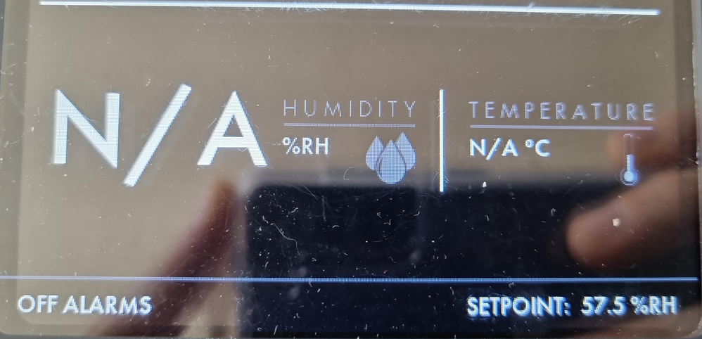

Screen looking as expected
How image usually looksHow image usually looks

I accidentally called MX_LTDC_Init and MX_DMA2D_Init twice, which likely caused the issues. It is now solved by only initializing once
