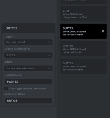

I've setup a project in TouchGFX4.18.1 and STM32H747i Disco, which consist of 4-5 screens. One screen is for motor control. In this motor control screen 3 buttons are used (low, medium, high) for changing the PWM. Simple but, the virtual function at the model (MVP) is calling the wrong Function.
The funny thing is, the order that a function is placed in the .HPP yields that the function to be called in model and it's not the correct function. I've used breakpoints throughout MVP, and all was validated as making the incorrect/correct call.
virtual void PWM_33(); (if PWM_33 is placed on the bottom, PWM_66 would be called for every button.)

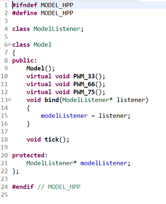

#ifndef MODEL_HPP
#define MODEL_HPP
class ModelListener;
class Model
public:
Model();
void bind(ModelListener* listener)
modelListener = listener;
void tick();
virtual void PWM_66();
virtual void PWM_75();
protected:
ModelListener* modelListener;
#endif // MODEL_HPP

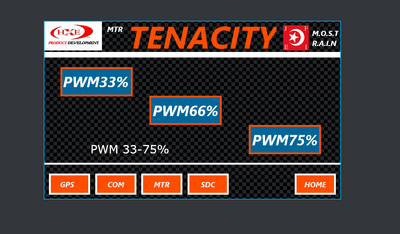

A hand held system is to be used for both. (Below: UI for Hand Held Unit)
