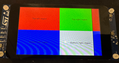

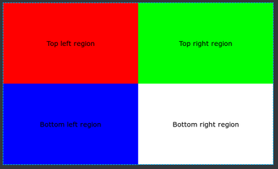

Using STM32F469I-DISCO in video mode, the testing screen created in TouchGFX Designer is being printed to the DISCO board in video mode. The issue I am encountering is the start of the frame is being printed again and I am not sure how to solve this issue, I have tried change different porch values but the problem persists, would anyone know what could be creating this issue and a method to solve it? Below is my method of creating video mode from a fresh TouchGFX Designer project, would this creation method be the reason for this issue?

2023-10-19 7:19 PM - edited 2023-10-19 7:19 PM
Pushing the porch values of HBP and HFP to the value of 120 seems to have solved this issue, I am not sure if this is the correct thing to do based on LTDC App Notes suggesting pixel clock is (2 + 120 + 800 + 120) * (1 + 15 + 480 + 16) * 60 which is 32 MHz and my LTDC clock is 30 MHz. I am not tagging this reply as a solution in-case this was not the appropriate thing to do.
2023-10-24 7:05 AM
Hello @JSime.1
I suggest you taking a look to the provided example : STM32Cube\Repository\STM32Cube_FW_F4_V1.27.1\Projects\STM32469I-Discovery\Examples\LCD_DSI\LCD_DSI_VideoMode_SingleBuffer
You can check the timings configuration and clock configuration in stm32469i_discovery_lcd.c also table 6 in AN4861
I hope it would be helpful!
