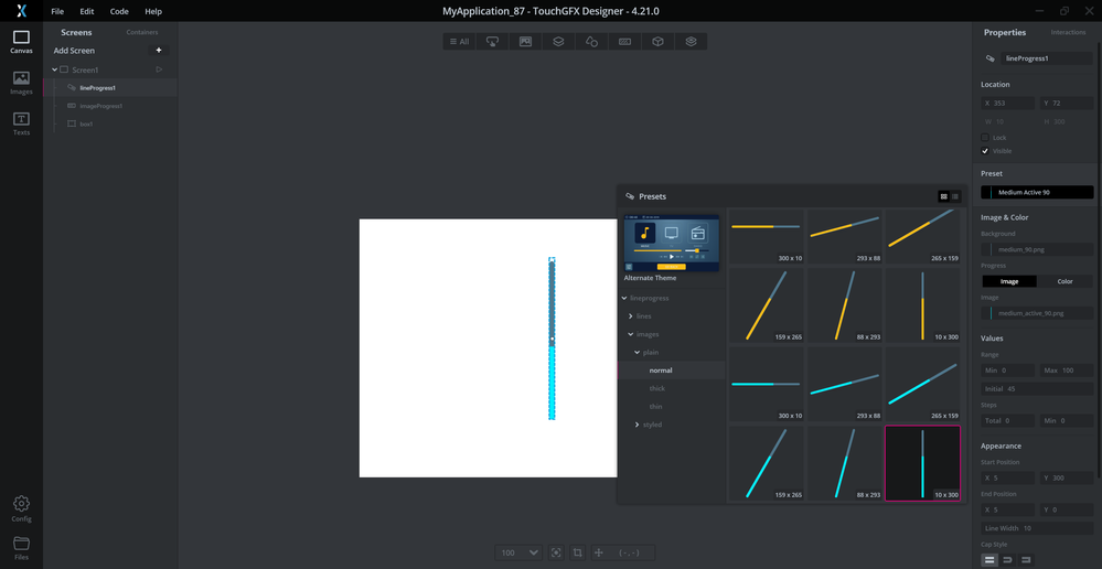

Is it possible to make vertical progress bar? Because I try to add progress bars and all bars is horizontal.
And here I see that I can't change progress bar width and height. (I add progress bar backgound).

Hello heyo,
Yes it's possible to make a vertical progress bar. I recommend you to use the Line Progress widget in which you can select presets of vertical progress bars.
