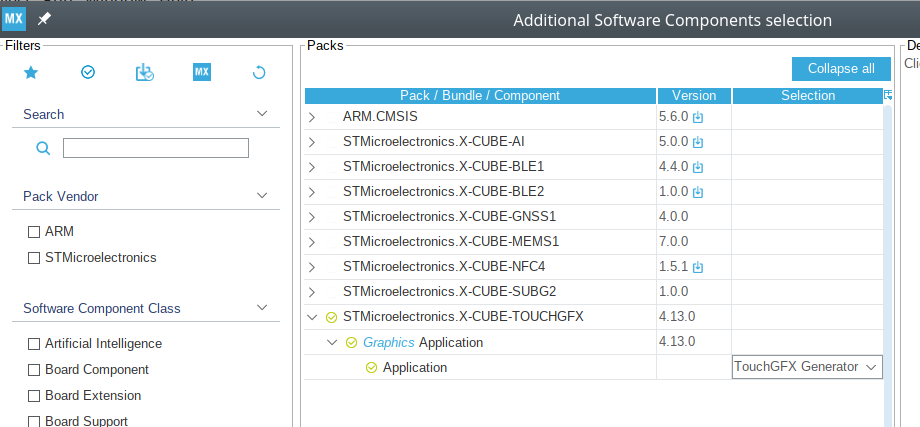

Cloud you explain me how. When I start new project, I select the board. Then I initialise all and open MX context. On the context I select additional software like :

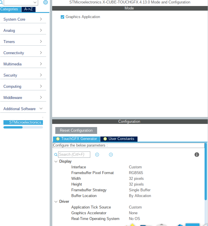

Then I enable toucheFX, but I can't use parallel connection only custom :
I don't have any button to start the editor nor I have any option related to the screen.
Could you tell me what I do wrong.
