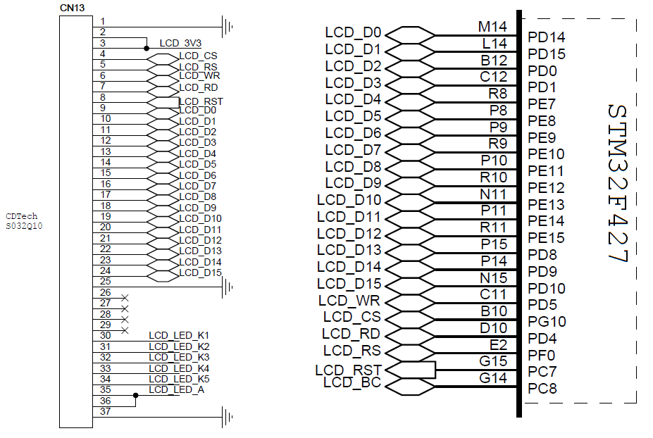

Do you have some schematic to post? (connections between LCD and FMC also the IM[3:0] pins) It will helps the community to advise you.

2017-09-25 8:13 AM
Hello Vangelis,
Thanks for answering, this is the connection i'm using.
https://community.st.com/servlet/JiveServlet/download/43760-1-9628/Project1.zip
