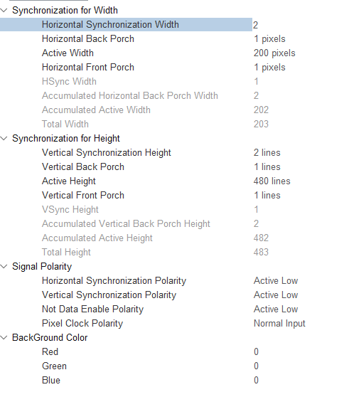

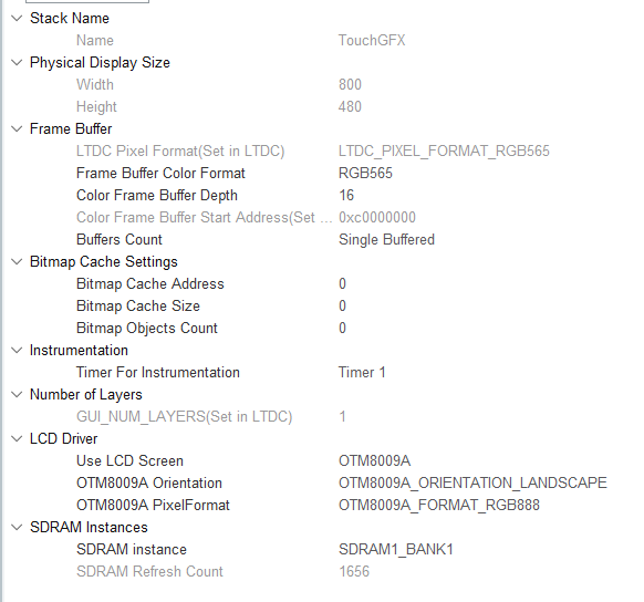

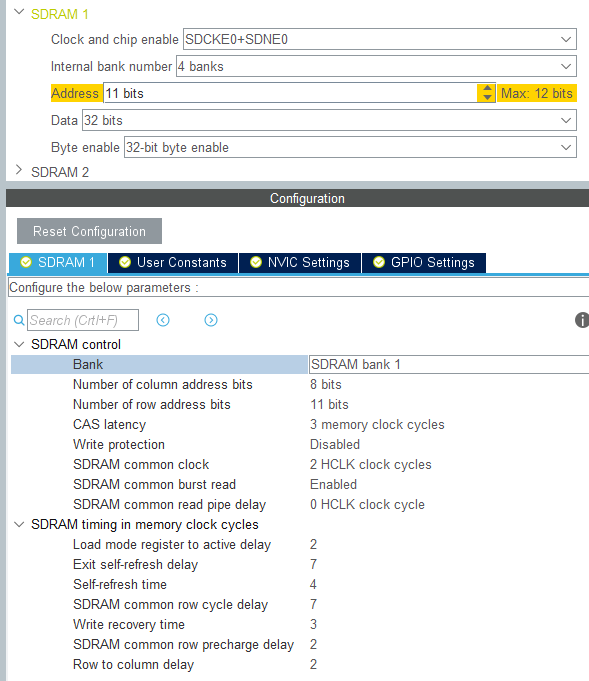

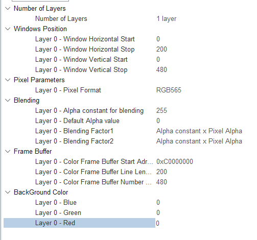

Maybe it is still from interested for someone: I got it working with a 32F469IDISCOVERY Board, CubeMX 5.2, TouchGFX 4.10.0 as Atollic Project.
Here are the steps:
If Display shows crap:
/* Activate XRES active low */
HAL_GPIO_WritePin(GPIOH, GPIO_PIN_7, GPIO_PIN_RESET);
HAL_Delay(20); /* wait 20 ms */
/* Desactivate XRES */
HAL_GPIO_WritePin(GPIOH,GPIO_PIN_7, GPIO_PIN_SET);
/* Wait for 10ms after releasing XRES before sending commands */
HAL_Delay(10);Hope this helps someone.

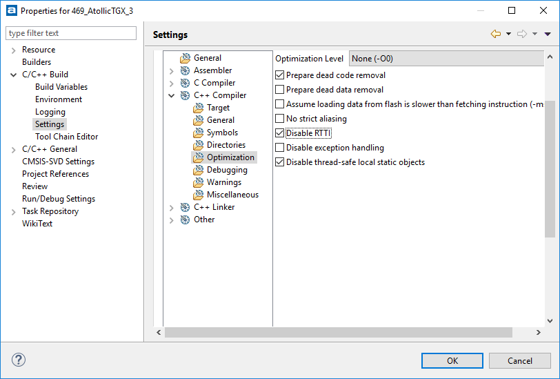

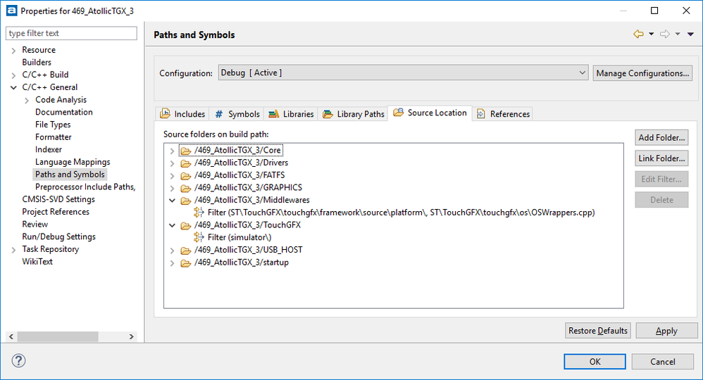

I've experienced and fixed some of these errors before. Let me paste the process for you here written by someone else that should at least fix compilation issues:
1. Start STM32 project in C++. "Starting C" doesn't work for ToughGFX project.
2. Enable "GRAPHICS" in Middleware with the following settings and generate code:
- Graphics Framework = TouchGFX
- Display Interface = Display Parallel Interface using LTDC
3. Press "Execute" button in Configuration tab of GRAPHICS to activate ToughGFX Designer to design the GUI. This evokes "Post Generation" error right after launching ToughGFX Designer and "Code Generation" error after pressing "Generate Code" button in TouchGFX Designer. These two errors could be worked around by changing "PostGenerateCommand" in ***.toughgfx file under \TouchGFX folder even though I think these two could be ignored since I've found these two errors do not have negative impact in STM32CubeIDE.
4. Exclude the following folders:
- \Middlewares\ST\TouchGFX\touchgfx\framework\source\platform\
- \TouchGFX\simulator
5. Exclude the following file:
- \Middlewares\ST\TouchGFX\touchgfx\os\OSWrappers.cpp
6. Include library in MCU G++ Linker\Libraries:
\Middlewares\ST\TouchGFX\touchgfx\lib\core\cortex_mx\gcc\libtouchgfx-float-abi-hard.a (sub x by concrete core used)
Libraries (-I): touchgfx-float-abi-hard
Libraries search path (-L): folder containing the library
7. Build project WITHOUT GENERATING CODE AGAIN.
After all the steps shown above, TouchGFX project finally worked over F746-DISCO. This is simply a good beginning since I still found some other issues shown below:
1. I got good result of compiling (0 error) by using STM32F469-DISCO and STM32F429-DISCO, but didn't get expected execution since both seemed to stay in prvPortStartFirstTask. I did not deep dive into this issue to see if I missed anything. It would be great if you could help give me more clue of this issue.
2. If I generated code again in CubeIDE after generating code in TouchGFX Designer, the file/folder exclusion got mess up so the exclusion needed to be set again.
