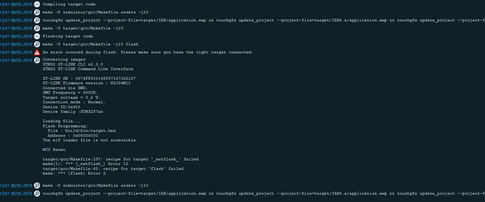

Could you show me a screenshot of the error?
/Martin

Hi @Martin KJELDSEN this is a screenshot of the error
PS: I run the clock demo successfully on STM32F746NG

I updated ST-link_CLI.exe on v3.4.0 and all the demos runs perfectly.
Thank you very much for your help.:smiling_face_with_heart_eyes:
2019-05-10 12:56 AM
You're welcome! Sometimes the firmware version of the ST-Link utility is incompatible with the firmware version in the ST-link chip on the board.
