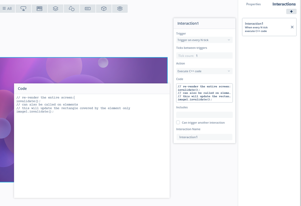

Can you try to create an interaction on the screen like the one in the screenshot?
It will force re-rendering the entire screen in every frame.

I tried the interaction to invalidate() but there was no change. Tried invalidate() whole screen and only the circle. Invalidating the whole screen actually added some new flickering.

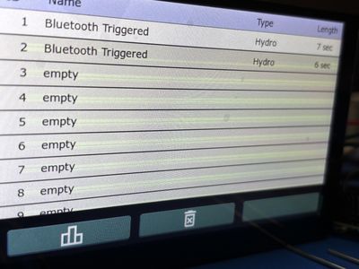

Here is another pic, showing a scrollwheel object with one white 'selected' container, on top row #1, and several gray 'not-selected' containers #2-#9. The noise is visible on the gray containers in this pic. If I adjust the gray color in the container by making it a bit darker or lighter then the noise can be eliminated. Just another example of the noise I'm seeing.
We're ordering new PCB's now, with a different connector for the LCD, and planning to assemble more than one prototype on this run, so hopefully we'll be able to clear it up. I'll post what I find.
