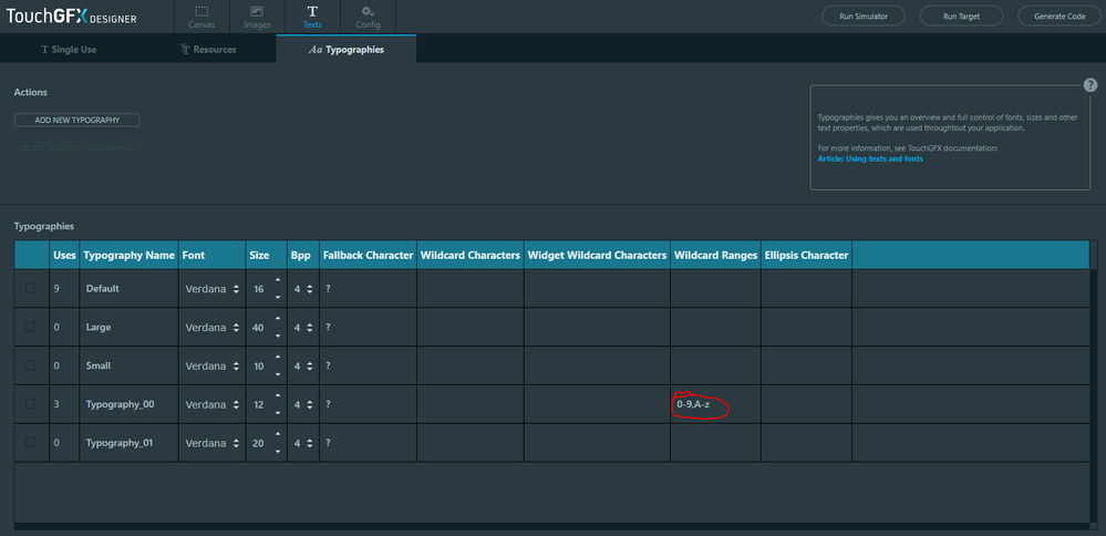

2020-01-11 9:35 PM
it looks like you don't have the characters you need enabled in the typographies section of Texts in the designer. that at least is whats happening with the numerical value
for the h and the 0 the font may not have those characters defined. I have read (on this forum) that different languages can have issues mapping characters. But if this is all english then I'm not sure
Bob
2020-01-12 10:41 AM
"it looks like you don't have the characters you need enabled in the typographies section of Texts in the designer."
Yup! That was it!
I simply added the desired character ranges in the typographies section; 0-9,A-z.
Thanks for the guidance!
