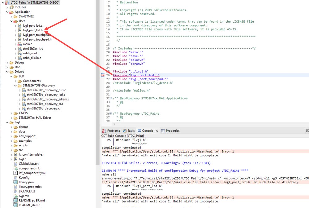

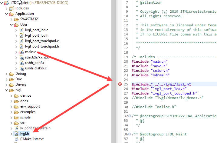

I have another similar question:
Why the compiler does not find lvgl.h, see screenshot below:
2022-10-21 6:54 AM
You need to write #include "../lvgl/lvgl.h" because ../ means exit the folder where your .c is.
So you exit User then lvgl is in the same level
2022-10-21 6:56 AM
Ok maybe I don't see well the picture, there is an other possibility
2022-10-21 7:06 AM
Right click on your project then go to properties-> C/C++ General -> Paths ans symbols and watch if the path of your folder with .h is in the list
2022-10-21 7:08 AM
ok that works, great, anyway it is not logical for me, because .c has two folders on top...
Still another similar failure, see screenshot below. What's wrong here?
2022-10-21 7:16 AM
I guess you add .h in a folder without .h in previously, can you check the path like I said in the previous message ?
2022-10-21 7:18 AM
now it works, thank you very much at all.
