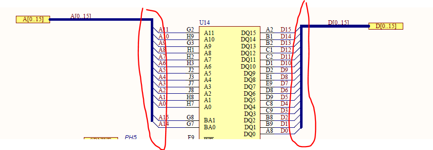

2022-02-15 7:24 AM
You mean these as control lines?
2022-02-15 7:26 AM
Well, I mean all lines carrying high frequencies: address/data bus, CLK, etc.
