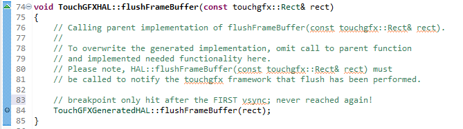

Considering existing posts and instructions in the documentation, I can't manage the framework to call flushFrameBuffer() regularly after a vsync.
The main issue is that TouchGFXHAL::flushFrameBuffer() is only called once after the first OSWrappers::signalVSync() (and never again). I've deleted all display drivers and checked with a breakpoint that is only hit once in TouchGFXHAL::flushFrameBuffer(). OSWrappers::signalVSync() is triggered by a button and an external interrupt callback. All code that I added is attached. The board is a F303RE Nucleo. Settings of TouchGFX see below.

Breakpoint gets hit.Breakpoint only hit on first button press!

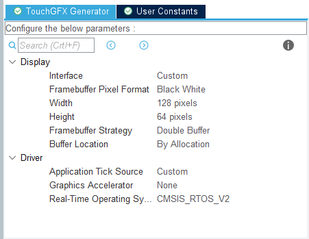

TouchGFX settings.

Indeed, the flushFrameBuffer function is called by the TouchGFX library only when something has changed in the frame buffer.

I'm aware of that. But all of the transmission (e.g. start of SPI DMA) would be located in TouchGFXHAL::flushFrameBuffer(), which is not executed (more precisely: it is only executed once after the very first vsync). That's why I have deleted all display driver code for this forum.

Oh, dear. Maybe I was thinking completely wrong. As the display has its own framebuffer: Is flushFrameBuffer() called when nothing has changed in the touchGFX framebuffer? I'll test it shortly.
2021-02-26 1:48 AM
