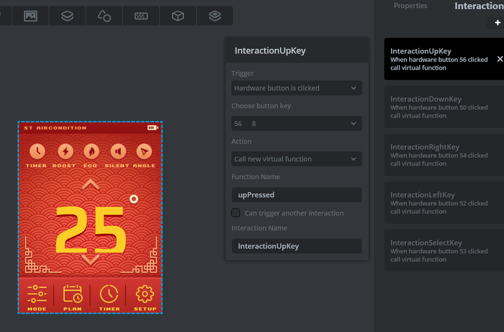

Checking an example I notiiced that the Action is set as:
and the interacion is set as
with Run Simulation i could manage with the keyboard of the pc, pressing the numbers ( 4 to go left, 6 to go right, etc). Idem when i flash the example to the board i can use the joystick.

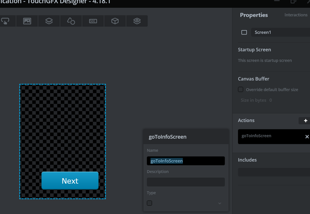

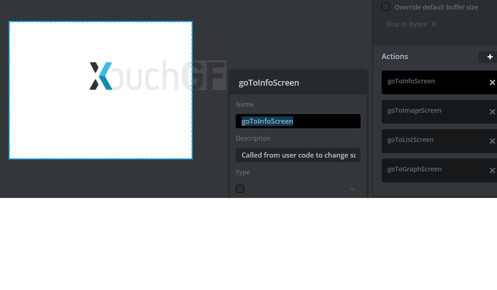

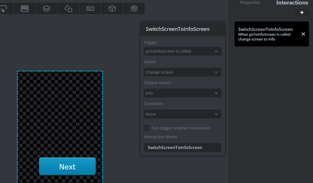

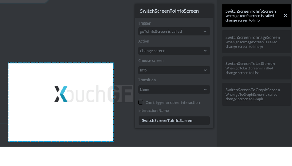

Checking a second example. the interaction setting is different.... there is no action and the interaction is completly different.

You need to set the GPIOs yourself in user code to be able to use them. Those demos have the joystick implemented, but the TBS for the STM32G0 nucleo does not.
To configure it I would just suggest to open your project in STM32CubeMX and compare it with the ioc file for one of the demos to see what gpios to set.

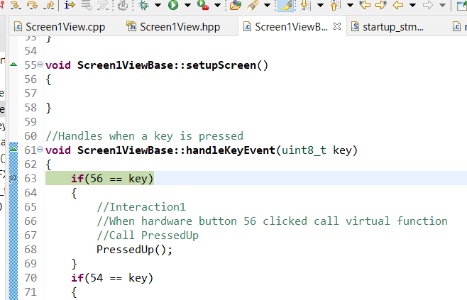

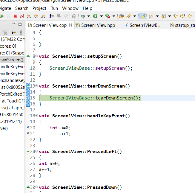

Hi Roman,
The GPIOs are configurated.

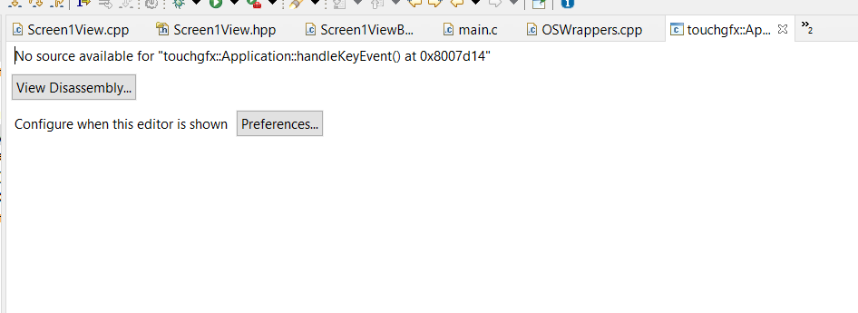

As you can see once a button of the joystick are pressed the ScrenViewBase recognize it. Unfortunatly the next spep is tearDownScreen.
and in the end crash
following the a part of the code:
the Screen1ViewBase.cpp and hpp
void Screen1ViewBase::handleKeyEvent(uint8_t key)
if(56 == key)
//Interaction1
//When hardware button 56 clicked call virtual function
//Call PressedUp
PressedUp();
if(54 == key)
//Interaction2
//When hardware button 54 clicked call virtual function
//Call PressedRight
PressedRight();class Screen1ViewBase : public touchgfx::View<Screen1Presenter>

void Screen1View::handleKeyEvent()
int a=0;
a+1;
void Screen1View::PressedLeft()
int a=0;
a+=1;
}class Screen1View : public Screen1ViewBase
public:
Screen1View();
virtual ~Screen1View() {}
virtual void setupScreen();
virtual void tearDownScreen();
virtual void handleKeyEvent();
protected:
virtual void PressedUp();
virtual void PressedRight();
virtual void PressedDown();
virtual void PressedLeft();
};thanks in advance
Fausto

Hum that tearDown issue sounds odd. Does it work in the simulator or does it crash only on target ?
Quick question, have you modified the Screen1ViewBase with user code ? You shouldn't as it will always be overwritten when generating code from TouchGFX Designer.
(just a tip to not call two variables "a" when working with C++. Initialize them in the screen1View.hpp, like int32_t a, b; ) Didn't know that "a+1" worked, never tried it so good to know :grinning_face_with_sweat:.
