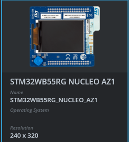

now i want to use TouchGFX in this project, i try the stm32wb55RG NUCLEO AZ1 demo
project in TouchGFX with stm demo board and it work perfectly,i notice the demo board
have the TE pin and external FLASH memory(MX25L6433F)that my DIY board don't have.
Is there possible to use touchgfx in my DIY board(without TE pin and external FLASH memory)?
