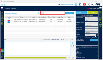

I recommend you to test the TouchGFX demonstration under \STM32Cube\Repository\STM32Cube_FW_F4_V1.28.1\Projects\STM32469I Discovery\Demonstrations\TouchGFX. Then, try to test the demo using STM32CubeProgrammer. For that, please flash the touchGFX demo.hex with MT25QL128A_STM32F469I-DK NOR_flash External loaders.
