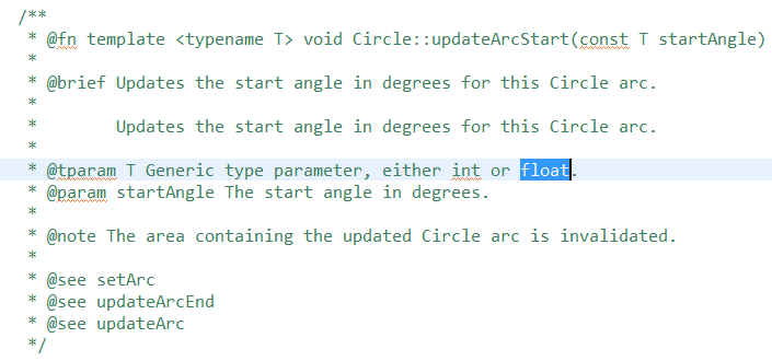

Would it be possible to add floating point parameters to the Circle widget in the Designer?
As of the latest version (4.14.0), only integers appear to be valid (start and end angle is in 1 degree increments, for example). It is possible to use floating points for the functions updateArcStart() and updateArcEnd() in the code:
Would it be possible to add this to the Designer as well?

Anything is possible, Scott! :) I'll do some detective work as to why there's no support for floats in the designer.

@Martin KJELDSEN
I see that the Circle Widget in the Designer does not support floats in the latest version of TouchGFX (4.15.0).
2020-10-28 7:56 AM
I forgot about this - made a stern reminder to myself to talk to the designer team about this tomorrow.

@Martin KJELDSEN
Hello Martin, I hope everything is well with you.
I see there is a TouchGFX 4.16.0 now. Do you know if the Circle Widget in the Designer supports floats in that version?
My project is at a stage where I don't want to update to 4.16.0 unless it is really beneficial to me. ;)
I believe it is supported in the code, but because of our Designing of various projects, I could really use floats in the Designer.

Hi @scottSD,
I don't think the designer team managed to get it in for 4.16.0 - I'll follow up on the priority of this task.
