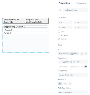

There was a post about this before, but the issue appeared to be happening for that individual only in a custom container, for me it has appeared on multiple screens.
In the example below, I've typed "1. Toggle Pump On/Off' and the text appears in the designer as "Toggle Pump On/Off .1", moving the 1. to the end and changing it's order.
See the screen cap below.

In a new/blank simulator project the issue appears not to be present (as was the case with the other thread on here). I therefore infer there's a setting somewhere that causes this issue to manifest.
I inferred it might have something to do with the Typographies, and after some comparison between the new project default and my existing project, I eventually noticed a difference: someone here clicked the button which changes font direction from left-to-right to right-to-left (see attached screencap); the manifestation is a little unexpected (to me), but I don't normally used languages the are right-to-left so maybe the behavior was as would be expected.
Thank you for your assistance, I consider this to be resolved.
