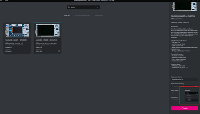

Hello @GaetanGodart,
I did try using v3.0.0, still the same issue. The loader that is generated is for REV1.1 and the ioc configurations also seem to match that of REV1.1 when cross checking with the datasheet...

Hello @CharanVis ,
It seems we have not made a template (we call that a TBS for TouchGFX Board Setup) for the rev10.0, if we had, it should be a previous version of the TBS.
Tried getting the demo code from TouchGFX Designer to work but failed to do so. We also tried using the U575ZIQ + RVA35HI template
What do you mean by "demo code" and "template".
It seems that the issue preventing you from having a plug and play option is the wrong version of the display, you should then get a rev1.1. This could be a solution if you only want to make a demo (and therefore did not buy a lot of rev1.0 already).
On the other hand, you could use the rev1.0 and make your own TBS, you could maybe use the rev1.1 TBS as a starting point. This won't be a plug and play solution as you would have to make a TBS but at least you won't have to wait for delivery and can reuse your rev1.0.

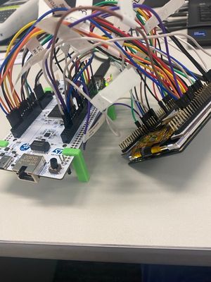

Hello @GaetanGodart @mathiasmarkussen
Behold, our creation:
How we are approaching this:
1) We decided to not change the TBS for the RVA35HI + H563ZI, rather adapt the connections off REV1.0 to match that of the expected connections for REV1.1 of the display.
2) This involved spotting the differences between the mappings of the respective versions and using female-male jumper cable connections from the display to the dev board. PS: Have attached the table we formulated for the above
3) Some key points to note is that, in the TBS generated, we could see up-to 8 Data Buses in total (ordered from DB0-DB7), whereas in the pin connections for REV1.0 of the display, there were more than 8 Data Buses attached to the connectors (CN7-CN12). What we decided to do was to simply ignore all the Data Buses after DB7 since .ioc file for the TBS expected only upto DB7. If what I have said so far is not clear, please feel free to ask for clarification :)

5) Unfortunately, we are unable to see the output on the LCD itself, it is just blank :(
Would you have any thoughts/suggestions or be able to point out where I may have gone wrong or have not considered certain things? Would really appreciate it :)

2024-12-12 4:31 AM
I have looked at the datasheet for the display controller on the display module (ILI9488). The interface type is selected via a set of pins, and as far as I can tell these are not routed to the connectors on the board. I assume that in this case, they are set to 16-bit mode, so it would not be enough to just connect 8 pins.
In case the backlight does not even come on, you can try to reverse the polarity of the PWM pin.
Just for reference, the V1 has never been supported directly by TouchGFX, but Riverdi may be able to help with some of these questions. They may have a solution for you, either by hardware or software means.
If you want to get your V1 working, you should connect all the data pins, define the actual pins used to some that are available in the connector on the Nucleo board and set up the FMC to run 16-bit mode. This should be fairly straight forward in CubeMX, but it is a lot of wires.
I will also reiterate that it is much simpler to debug this if you make sure to keep assets in internal flash until the screen works.
Then, when the screen works, try external flash, and if you have problems with that, ensure that the data you expect is actually available in the flash and also read properly by the MCU.
In the end, you will probably be a lot better off if your second module ends up being a V1.1.
