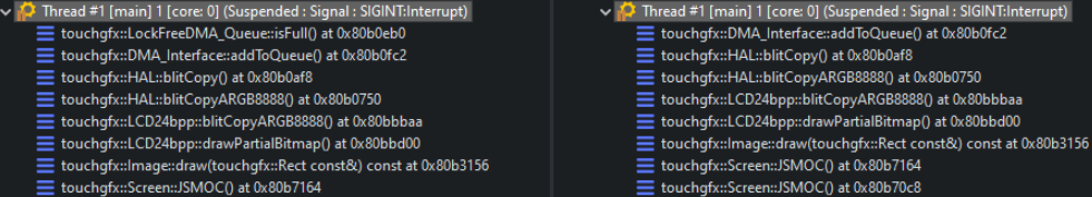

I have a problem with a stuck TouchGFX task. When the fault occurs, the TouchGFX task uses almost 100% CPU time and completly prevents lower priority tasks from executing. It seems to be stuck at a DMA transfer, altering between LockFreeDMA_Queue::isFull() and DMA_Interface::addToQueue()

Debug trace is alternating between these two functions when the TouchGFX task is executed

For some reason, the DMA interrupt is not firing anymore. As a result the DMA_Inferface fails trying to initiate a new transfer and locks the TouchGFX task.
Now i need to figure out why the DMA interrupt will not trigger anymore.
