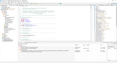

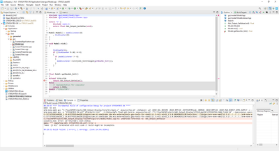

The project can display a float constant (the 1.5555) in the Simulator on TouchGFX (refer to Model.cpp file), but in STM32CubeIDE, there are 2 build errors as show below (As a result, unable to show the float constant from main.c on the screen.):
(Copy from the Console of STM32CubeIDE after build):
C:/TouchGFXProjects/ADC_Output_Display/TouchGFX/gui/src/model/Model.cpp:30: undefined reference to `Adc_Output_GetValue'
collect2.exe: error: ld returned 1 exit status
make: *** [makefile:103: STM32H7B3I-DK.elf] Error 1
"make -j2 all" terminated with exit code 2. Build might be incomplete.
17:19:18 Build Failed. 2 errors, 1 warnings. (took 29s.943ms)
The Adc_Output_GetValue() has already been defined both in Model.cpp and main.c; so not sure what means the: undefined reference to ‘Adc_Output_GetValue’; and do not know what to do next.

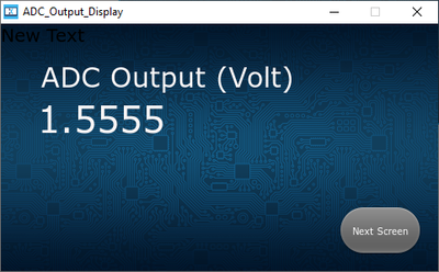

Simulator result:

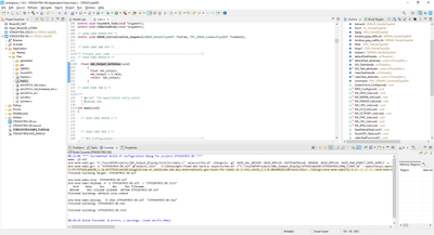

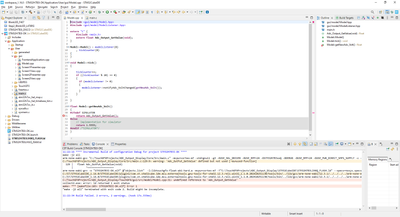

and have moved the function out of the while(1) loop, first place it under /* USER CODE BEGIN 5 */ not working, then place the function under /* USER CODE BEGIN 1 */ inside int main(void); it still can not build. Getting the similar build errors from STM32CubeIDE:
C:/TouchGFXProjects/ADC_Output_Display/Core/Src/main.c:129:9: warning: 'Adc_OutPut_GetValue' defined but not used [-Wunused-function]
129 | float Adc_OutPut_GetValue(void)
C:/TouchGFXProjects/ADC_Output_Display/TouchGFX/gui/src/model/Model.cpp:31: undefined reference to `Adc_Output_GetValue'
11:22:34 Build Failed. 2 errors, 2 warnings. (took 17s.333ms)

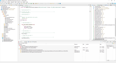

Below the two print screens from STM32CubeIDE:
Enclosed also Model.cpp (as shown below) and the main.c as an attachment.

2025-01-30 6:10 PM
Your function is still in the wrong place, it needs to be outside of the main function.
Place it in the /* USER CODE BEGIN 0 */ section.
2025-01-31 4:11 PM
Thank you AMars.4 for your reply.
I have placed the function under the /* USER CODE BEGIN 0 */ in main.c
The Model.cpp remains the same (unchanged).
In the build results, "the warning for main.c 'Adc_OutPut_GetValue' defined but not used" disappear; thank you.
The current STM32CubeIDC build results:
09:28:32 Build Failed. 2 errors, 1 warnings. (took 1m:34s.826ms)
and the print screen:
The build error, Model.cpp:31: undefined reference to `Adc_Output_GetValue' is still remained.
Not sure how to overcome this.
Enclosed also the updated main.c
Thank you very much for your time and support. I look forward to hearing your advice.
With best regards
EY1
2025-01-31 11:20 PM
The function in main doesn't match what you are calling from the model because of the upper case "P".
Change from "P" to "p" in the two places in main.c that you need to....
"Adc_Output_GetValue" instead of `Adc_OutPut_GetValue"
Every reference has to match exactly.

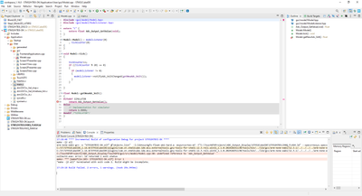

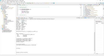

2025-02-01 3:20 PM
Thank you AMars.4.
Thank you very much for your advice. I have fixed this function name error in main.c. The project can now be built in STM32CubeIDE, and working in the STM32H7B3I-DK Board.
The following are the two print screens:
Thank you very much for your support. I greatly appreciate all your help.
