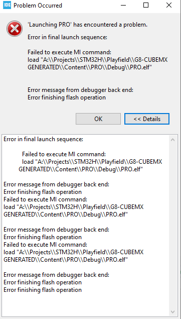

Hi @Alexandre RENOUX ,
I did do this exactly. I compiled a standalone TouchGFX project, copied the linker file (ld) and did exactly what you described. It still does NOT work.
Linker File Differences
The difference between the linker file generated between TouchGFX and the CubeMX is actually further than what you described. The differences are :
1- Memory Section as you described above
2- A FramebufferSection added at the end of the linker file generated by TouchGFX, i copied that code below
FramebufferSection :
*(TouchGFX_Framebuffer TouchGFX_Framebuffer.*)
*(.gnu.linkonce.r.*)
. = ALIGN(0x4);
} >RAMFB
FontFlashSection :
*(FontFlashSection FontFlashSection.*)
. = ALIGN(0x4);
} >OSPI
TextFlashSection :
*(TextFlashSection TextFlashSection.*)
. = ALIGN(0x4);
} >OSPI
ExtFlashSection :
*(ExtFlashSection ExtFlashSection.*)
. = ALIGN(0x4);
} >OSPIWhat I have done
1- I copied the linker file generated by TouchGFX and replaced the one generated by CubeMX and simply compiled
The result: Successful compilation but error when clicking debug, See photo below. The error goes away when the linker file is returned to the original generated by CubeMX
2- I simply replaced the memory lines as you described above in the linker file generated by CubeMX and same error above happened.
3-I replaced all the main file generated by TouchGFX with the main file generated by CubeMx and lots of errors showed up
4- I tried to fix all the errors in step 3 one by one such as replacing core files, library files and driver files and the errors got worse.
I tried everything rational I could do but nothing worked. Thanks for your feedback though, do you have other thoughts? It would be nice if you could have access to the actual board so that you can see that nothing works as advertised.
Looking forwards & Thanks for your help again :)
