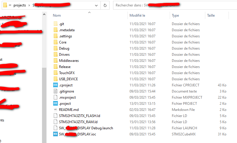

Signal 67My project structure is at followed:

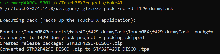

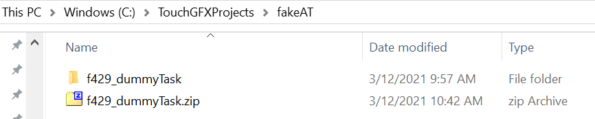

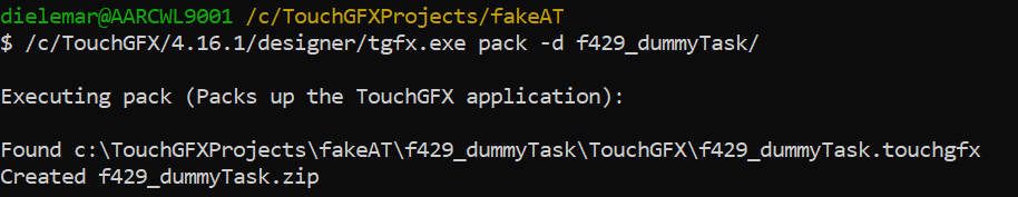

I believe you are not in the right folder and should not be using the .touchgfx project in the command but the folder (no need for the / at the end).
Here is the steps I did for a fake AT of one of my projects on the F429 disco board:

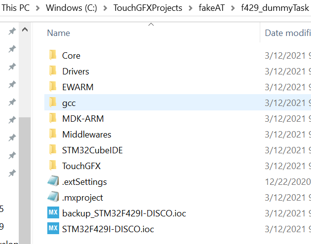

My folder look like this (zip file was created by the command above):
Out of curiosity, you are working on a custom board. Did you use CubeMX and developed your project similarly to what we do with the application templates for the dev kits like in the following screenshot ?

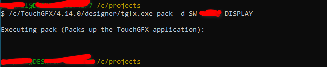

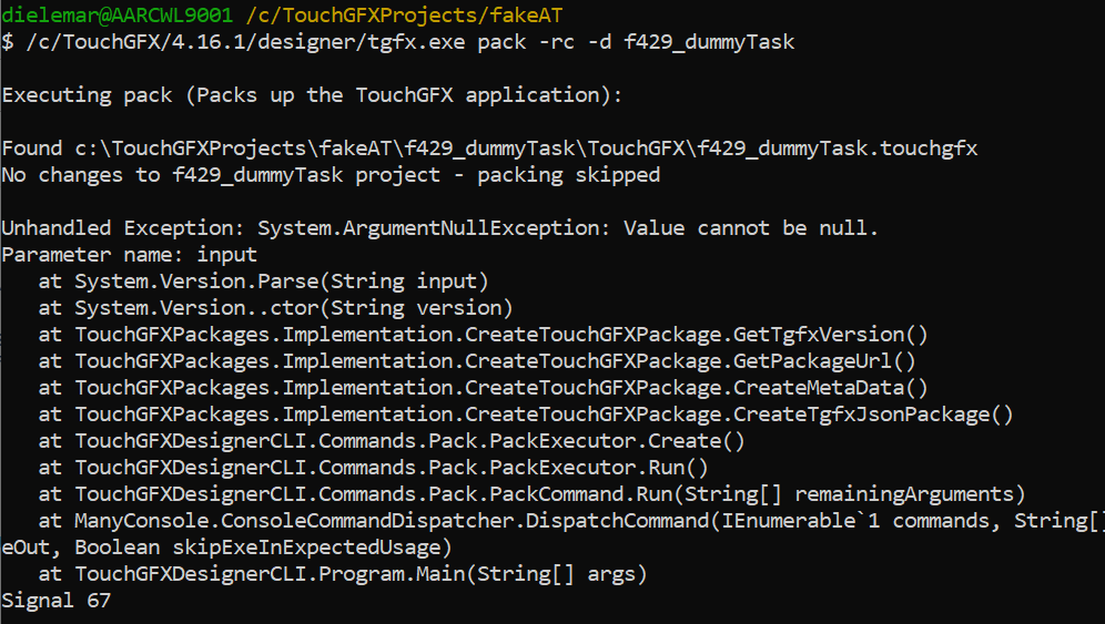

2021-03-12 4:37 AM
I actually met issues creating a tpa (the next step), I do not know if you will face them as well but just in case, what I did to avoid them was to download in addition TouchGFX 4.14 and run the commands from the TouchGFX 4.16.0 environment but using 4.14 in the actual command , so like this:
$ /c/TouchGFX/4.14.0/designer/tgfx.exe pack -d demo/FYI the errors I faced with 16.1 are the followings:
I investigated and could only make it work with TouchGFX 4.14 or older. I informed the team to know how we can fix that and find the source of the issue.
Hope this helps
/Romain

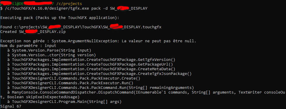

Hi, you're right I messed up with the commands and folders; though before doing that I also tried with the right commands and also got some errors.
My project has been generated by CubeMX, and has the same structure as your:
(sorry I blur some infos, forget about the project one in my first post it is not the same as this one, it was just an example from a generated project by TouchGFX with an official demo board)
Indeed when I run the proper command with TouchGFX 4.16.0 environment it end up with the same exception:but the zip file is well created (not the json).
So I installed TouchGFX 4.14.0 and runned the same commands with the TouchGFX 4.16.0 environment as you mentionned in your second post, and it ends up like this :
nothing happens

FYI when I added the software pack TouchGFX to my project I think it was TouchGFX 4.15 at that time (but my project has now everything updated to the last versions). My project also hasn't any space in the file names nor dot, and the folder, .ioc and .touchgfx are named the same.
