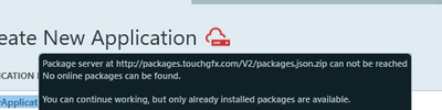

PS. You may wonder why I didn't use 4.16.1. For some reason I cant see any TouchGFX Board Setups (TBSs) when creating new project, only simulator. It gives some error like:
