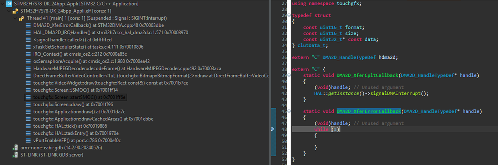

Hi again @ferro I found another bigger problem with rotation. If I add a mjpeg (avi) format video and use rotation feature, it stucks at DMA2D_XferErrorCallback.
By the way in this project XSPI channels are swapped with same pin configuration.

Aha, no idea what this means.
I suspect some well-seasoned Gfx veteran is already observing this thread and will join the discussion soon.
Regrettably, I cannot devote more time this week. Sorry. I would start with my example - that should work as expected.
