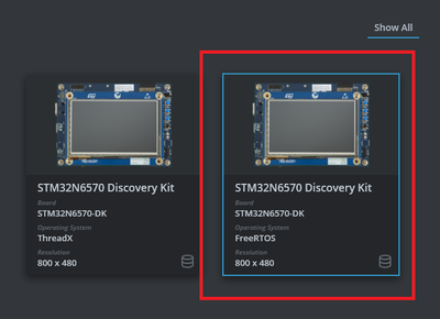

I've just created an empty project starting from a TBS board by selecting FreeRTOS flavor in TouchGFX Designer 4.26.0:
Generated the code with TouchGFX designer:
then compiled the two projects available. None of them showed an issue in compilation. I'm using the latest version of CubeIDE 2.1.0.
