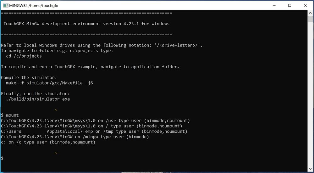

Also, could you mention the build version of the Windows 11 that you are using? And a screenshot of TouchGFX 4.23.1 Environment (you can run it from the start menu just by searching for it) running mount command, something like this:
TouchGFX Environment

4. TouchGFX 4.23.1 Environment screenshot is in the attachment.

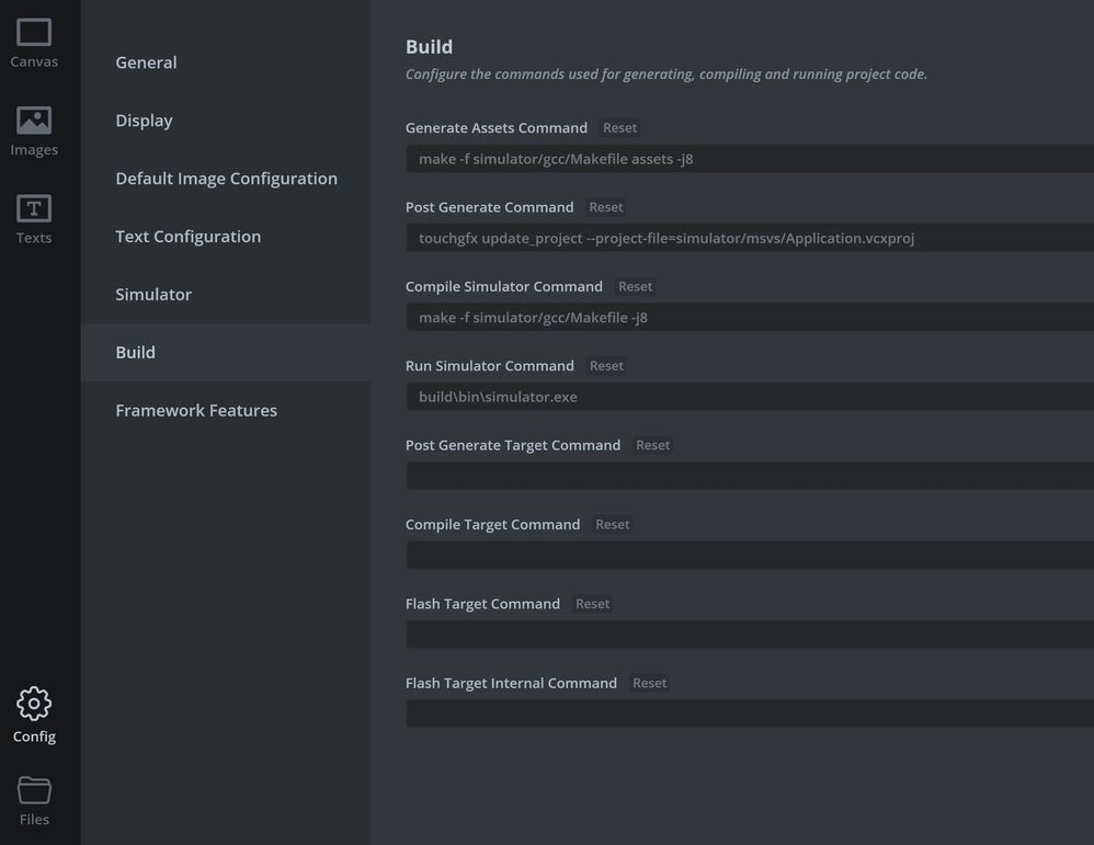

2024-02-09 1:06 AM
Hello again @ali_ ,
Have you applied any changes to the Build commands in TouchGFX Config?
I mean this section:Build Commands
