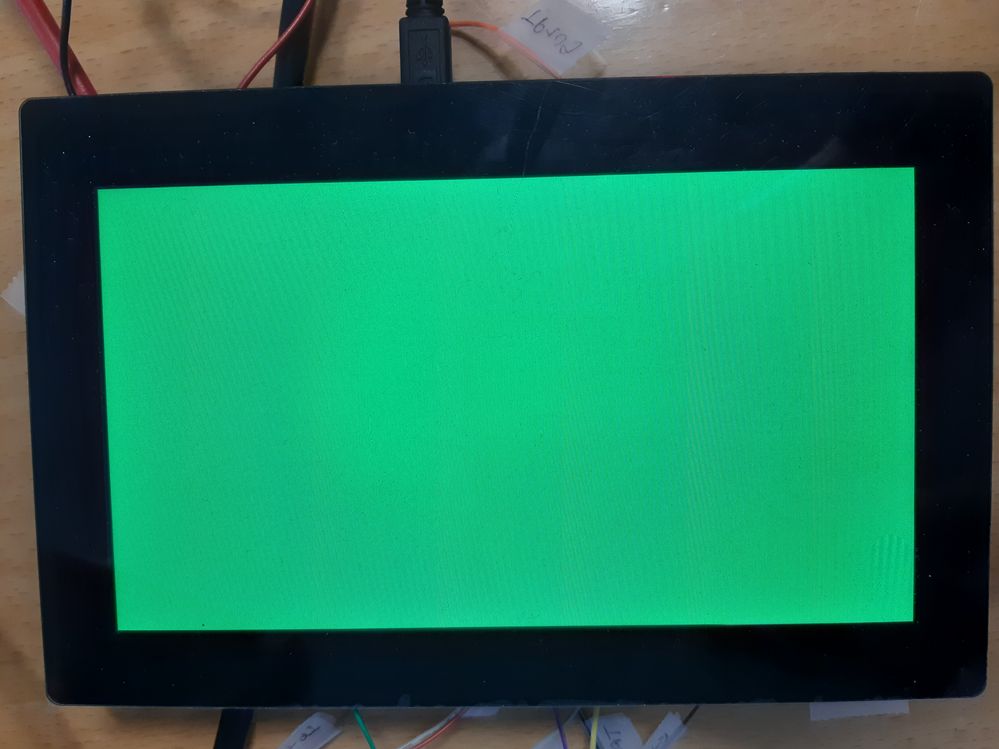

}The external RAM is then transferred though MIPI DSI and shown as expected:

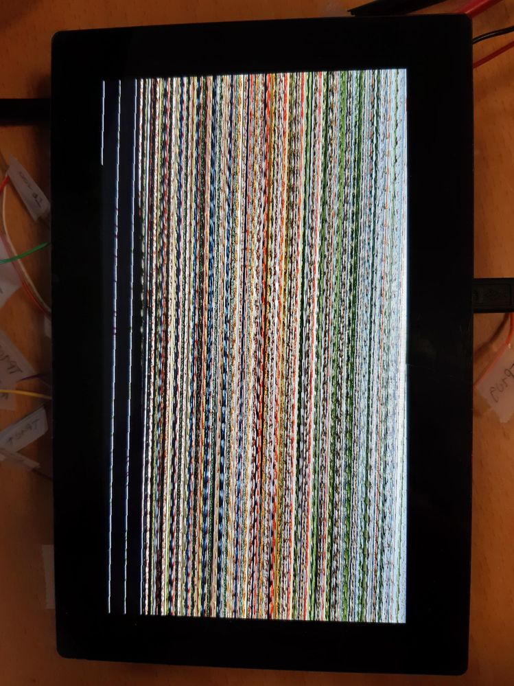

However if I enable TouchGFX through Cube MX and it write to the framebuffer I do get some strange display issues on the screen:
I am working in RGB888 mode and a screen with 1024x600.
Does someone have any idea why the image is not written correctly in the framebuffer by TouchGFX. Or do I have some other timing or formatting issues?

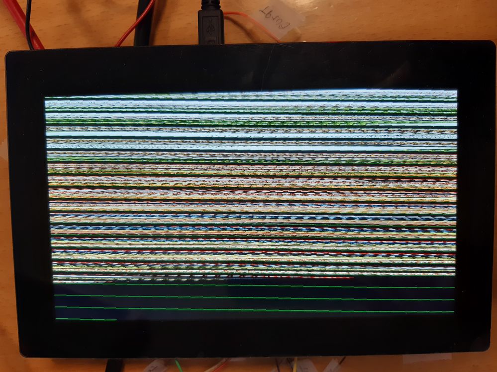

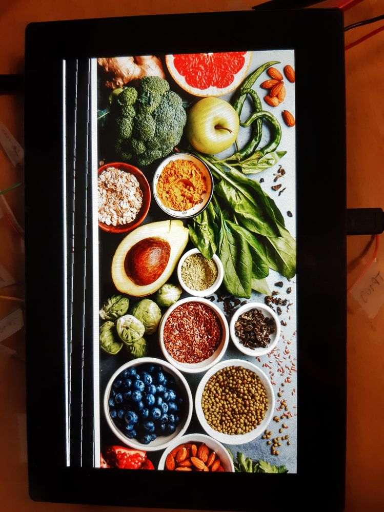

Ok I implemented a better test. I am now drawing the image generated by TouchGFX (RGB888) by DMA2D to the framebuffer at position 0,0. The image is copied to the buffer and from there through LTDC and MIPI DSI to the screen:
That prooves that the drivers work and all timing is correct:
Now If I create a screen in TouchGFX and put the same image in the screen and let TouchGFX draw the image to the framebuffer it looks like this:
So it must be some kind of configuration in CubeMX or TouchGFX but I really dont know what could be wrong. Any Idea?

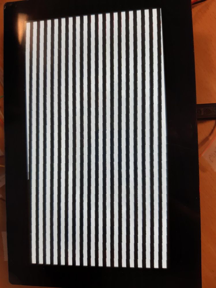

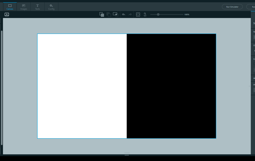

I did another test to clarify:
I set up a black white screen in touchGFX:
Running the program produces this frame:
So its not really image processing, its some kind of configuration that is totally wrong, but I dont get what it could be. Some help would be really appreciated!

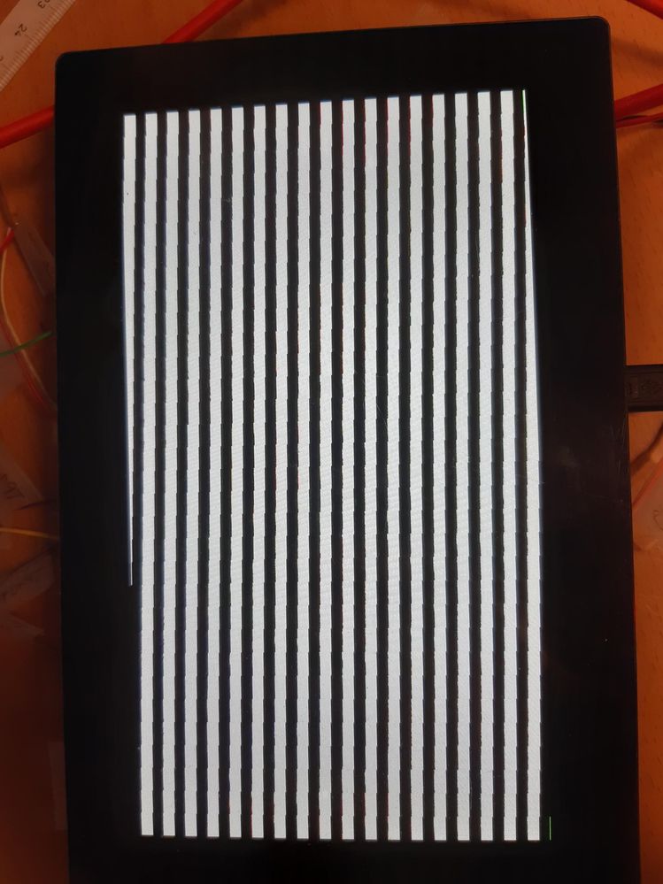

2021-05-04 9:17 AM
Yes I do use a fully generated CubeMX Project with TouchGFX enabled under Software Packs. I also do exactly what you propose and draw the image out before the activate touchgfx gets called.
I do have another interesting observaition: I've put two lines of 32 pixel of the color green on the right side in TouchGFX. The second line is then not shown on the right but at the very beginning of the second line. So theres some kind of shift for each line written to the framebuffer. That explains why the image is shown this way. You have to look at the first two pixel lines in the image:
