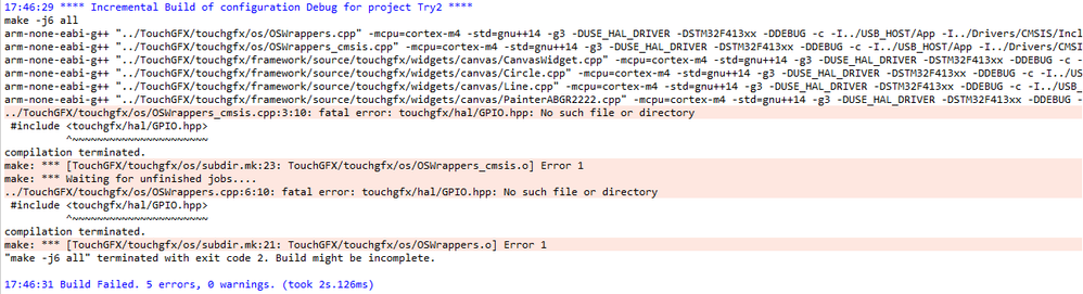

thank you for your fast reply. I already tried this method with STM32CubeIDE and, I don't know why, some files in "TouchGFX" folder return me an error that says "No such file or directory", even though the file in that specific path exist. Moreover, I found on the internet that that could be caused by the fact that you didn't generate the code, but I generated it three times in order to avoid this problem, but it comes anyway.
Can you explain to me why it returns an error like this?
I will attach an image of my console with error, so you can understand better what is my issue

Yes that error usually appears when you have not generated code from TouchGFX Designer.

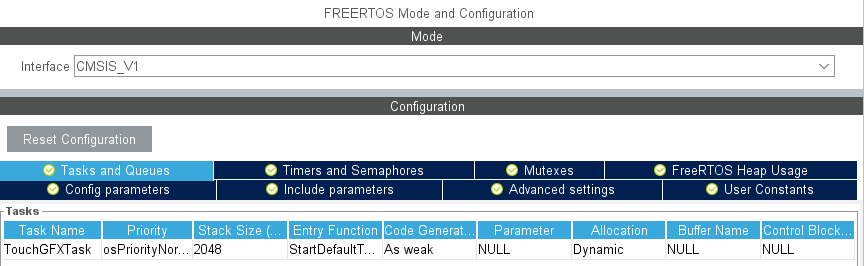

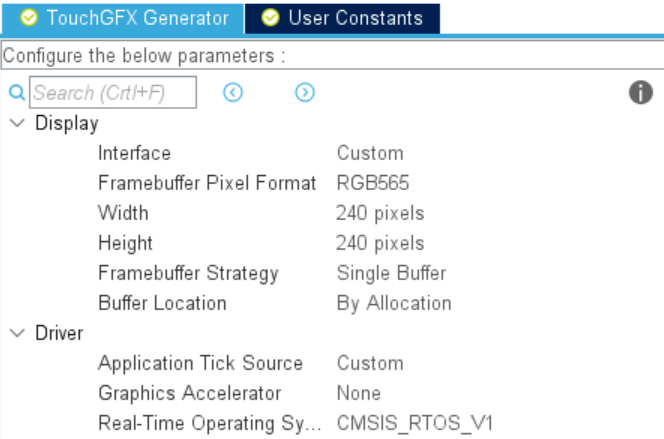

I do not have a F413 disco board so I cannot debug or run a project on it. I suppose you just created a project with the preconfigured settings? When we develop ATs we generally set FreeRTOS as default so maybe give a try to the following settings ?
In additional software:
In Middleware, enable FreeRTOS and add the following task in the "Tasks and Queues" tab.
We now need to make sure the process function is called in the task handler: in the code, in main.c go to the void StartDefaultTask(void *argument) function and add MX_TouchGFX_Process(); in the user code section.
Have a look at the Generator User guide documentation to understand how it works and what else to configure if relevent.

I noticed another thing: I tried to put the include lines that give me back the errors I mentioned, and the program will still give me an include error to the next included file, until I commented all include files and it gave me errors that the functions recalled don't exist. How is that possible?
Moreover, I tried to use F3, the shortcut to open the declaration file, and it finds the right file. It doesn't make any sense, does it?
In the pictures I attached, you will see that the program gives me the error on the second include, but only with the include that has "touchgfx/hal" in its name. Is that weird?
