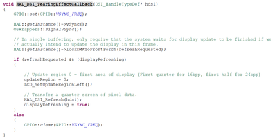

Now when TouchGFX starts, taskEntry sits at OSWrappers::waitForVSync(); I assume that this VSync should be called from HAL_DSI_TearingEffectCallback in TouchGFXHAL, but this callback never fires. It appears a tearing effect is requested earlier in taskEntry by LCD_ReqTear, which in the discovery code writes OTM8009A_CMD_TEEON to the LCD driver. I have modified LCD_ReqTear to send OTM8009A_CMD_WRTESCN with a param of 533 (0x2,0x15) instead, as per the CMDMode_TearingEffect example, but the TearingEffectCallback is still not triggered.
What am I missing here? I can't attach the full project for confidentiality reasons, but I'm happy to share main.c and TouchGFXHAL.cpp
I'm aware also that TearingEffectCallback and EndOfRefreshCallback still contain code that assumes the display is split in two (as per both the examples I have borrowed from), I wouldn't have thought this was the issue however, as neither of these callbacks ever fire.

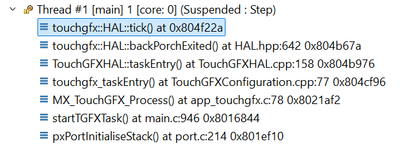

This is the stack from the point that the task locks up
Without access to the HAL source, I can't probe this any further

It looks like the OS thread hangs when it is set to delay.
Have you set up your OS according to Real Time Operating System | TouchGFX Documentation?
There is a thread delay in the draw loop for some refresh strategies. Do you have an implementation of

The touchgfx task starts and cycles as expected, with flushframebuffer being called. BUT, because there is no TE pin, the tearing effect callback never gets called and the below code never executes - I'm back at square 1! What should trigger this code instead of the Tearing Effect?

As I said, you would probably be better off with two frame buffers, and you should definitely find a way to get a TE signal, but I guess you will just have to experiment a bit with the registers on the board. I would suggest enabling everything related to TE and seeing if you get something. You will get tearing regardless of your frame buffer strategy unless you can get the display and the MCU in sync.
Trying to initialize the display in video mode is also an option, then it will be synced by the LTDC V-blank signal.
The display on MB1166 is actually a portrait mode display, which is the reason for the "split" screen code. I would suggest initializing it as such, setting the LTDC and framebuffers to 480x800 and running a rotated UI in TouchGFX if you discard the split screen code.
