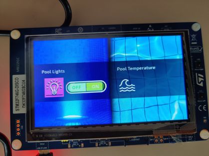

- Problem 2: incorrect display of toggle button and light icon
After opening the project with STM32CubeIDE 1.16.0, compiling and running the project. It interacts but the LED icon and the toggle button are still displaying incorrectly.

Flashing using the programmer or the IDE both running and Debug mode results in Problem 2; It is possible to interact with the toggle button by turning off and on the pool light , but the icons are not displayed correctly (Green and ugly).
I tried generating other demos or examples from the TouchGFX by specifying the Board, generating the code, running to target and they don't work!! (Also by opening the project with STM32CubeIDE).
