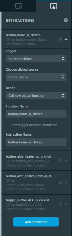

I'm having difficulty in creating multiple screens, currently, it already has 5+ screens and they all works fine through code (void FrontendApplicationBase::gotoMainScreenNoTransition() ) but when I tries to add one more screen, TouchGFX is not generating the Screen Transition Declarations code for new screen but it does declaring this in FrontendApplicationBase.cpp class :
#include <gui/aldetruma_screen/NewScreenView.hpp>
#include <gui/aldetruma_screen/NewScreenPresenter.hpp>
while for all other screens it has generated the following:
transitionCallback = touchgfx::Callback<FrontendApplicationBase>(this, &FrontendApplication::gotoMainScreenNoTransitionImpl);
pendingScreenTransitionCallback = &transitionCallback;
Any thoughts will be very helpful.

2021-10-13 1:34 AM
Hi Romain,
I'm using TouchGFX 4.15.0 version with STM32CubeIDE 1.5.0
Even If I add screen transition, it still not generating the goTo<NameOfScreen>NoTransition() function.
And it's not causing any compilation error. I have also added the screenshot of the only declarations being added by touchgfx in FrontendApplicationBase.cpp class.
2021-10-13 1:53 AM
I think I have found the issue, I was using navigation screen for all of my screens and completely forgot it to add the interaction. It was really frustrating. But thanks for your valued input.
