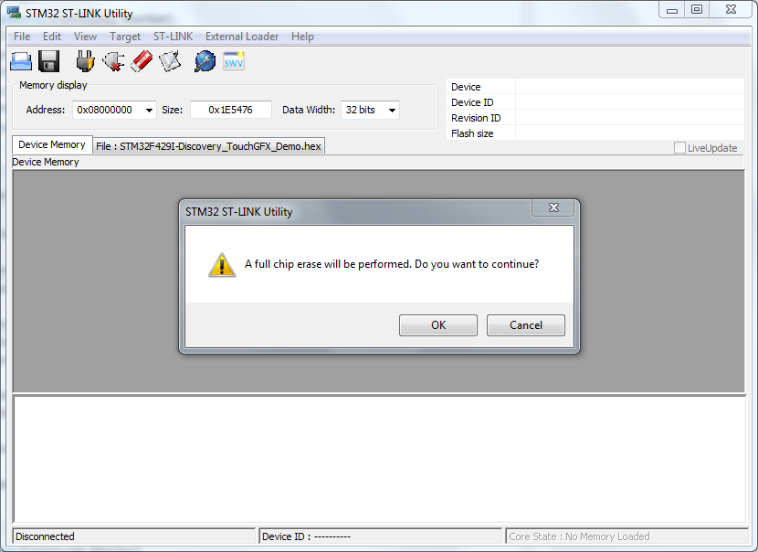

Try a full Chip Erase and see if that helps:
2019-01-08 1:33 AM
Hi again,
full chip erase does not help. The memory is volatile. The data in SDRAM are random when ever it starts from power up.
