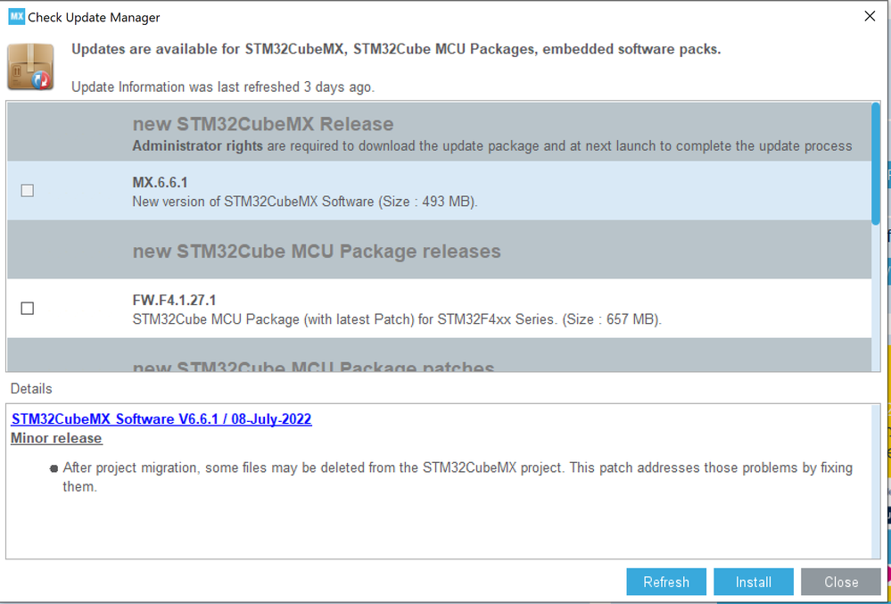

Hello @awiernie ,
I know that there was some issues with file deletion with CubeMX 6.6.0.
They just released version 6.6.1, can you try to regenerate with this one and let us know ?
Thank you,
/Yoann

2022-07-15 2:54 AM
Hello @awiernie ,
Thank you,
/Yoann

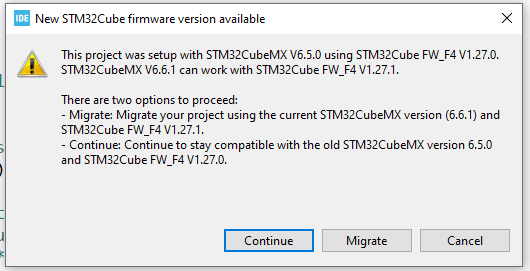

2022-07-15 5:28 AM
I had already installed 6.6.1, but I clicked continue (and not migrate):
Now I have migrated and the code was not erased - the TouchScreen works again.
