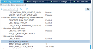

https://freertos.org/Documentation/02-Kernel/02-Kernel-features/05-Software-timers/03-Timer-daemon-configuration
See documentation of FreeRTOS software timers. The parameter in the ioc.-File is shown in the screenshot:
Increasing this parameter to a higher value than osPriorityNormal should work.

2025-11-27 2:44 AM - edited 2025-11-27 2:52 AM
Give it a try and get back to me if it works.
