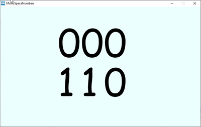

I used the font Comic Sans MS in size 150.
We can easily see that the '1' are narrower than the '0'.

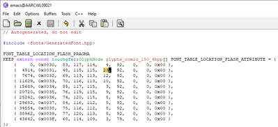

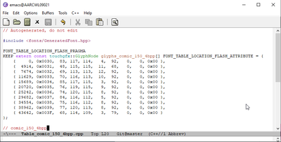

This can also be seen in the generated output. Take a look in the file generated/fonts/src/Table_comic_150_4bpp.cpp:
This table describes the width, height and other properties of the letters in the bitmap font.
The second number is the unicode. The 7'th number is the advance. This is the number of pixels that the "cursor-position" in moved after drawing the letter. We see that unicode 0x0031 = '1' is has an advance of 68 pixels, whereas the other number have advance=92.

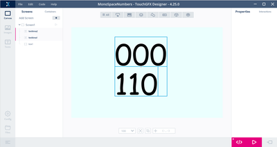

If I modify 68 -> 92 I get this screen in the simulator (Designer still uses the TrueType file):

The number before the advance is the left indent.
Adding 12 here moves the '1' to the center of the letter box:
Changes this:
to
I hope it is useful.
