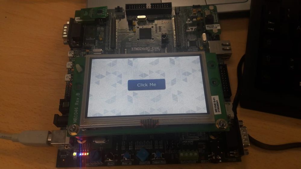

2018-12-19 10:50 PM
Hi, @Mon2 ,
Yes i agree with you, i migrated to Attolic TrueStudio and it work better and without error,
Now i can display my GUI on my eval board without any limitations.
I'm working now on a tutorial and i'll shared it in this community :) *
This is my first example using CubeMx 5.0.0 and touchGFX 4.10.0
