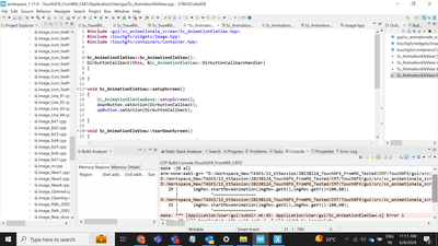

I have tried to use mentioned API but getting some error for linking file.
Please let me know if we needed to add some header file

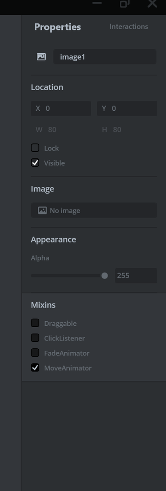

You need to check the checkmark for moveAnimator in TouchGFX designer like I mentioned before.
Let me know if this helps. If not please test if it works in TouchGFX Simulator first and show the entire error message.
2024-06-04 1:04 AM
Also, you can insert code by clicking on this icon:
It is way easier to review code this way rather than screenshoots.
