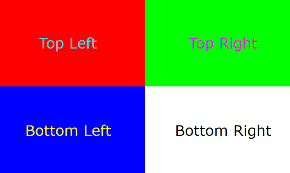

I'm testing it with this simple screen:

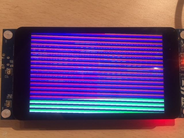

I get an image which has pixel rows shifted a few pixels on the right with respect to the previous one.

I tried with coloured text on the rectangles:
With the previous settings, I get the same skewed pattern, with skewed text. The color of the skewed text matches with the background.

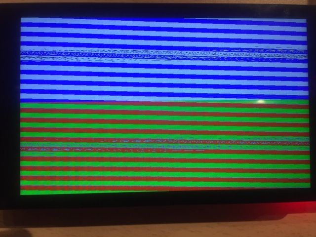

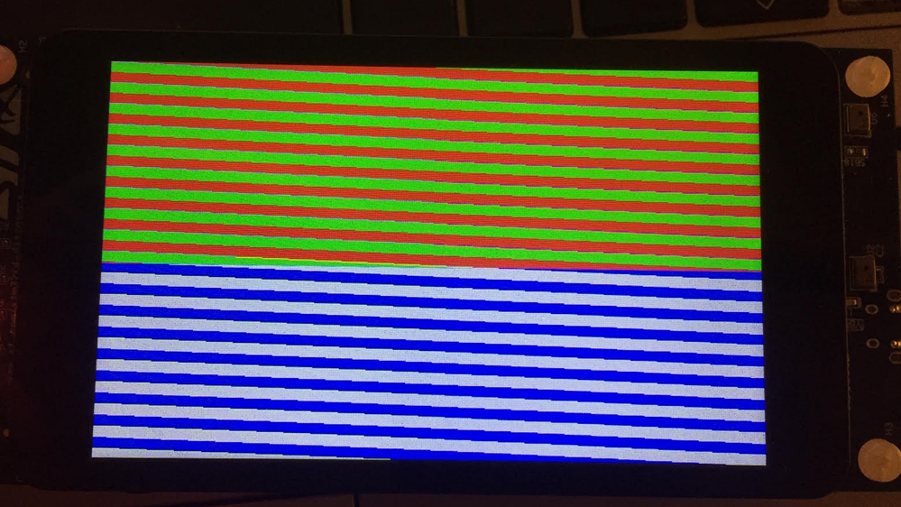

Chosing portrait orientation on TouchGFX, seems to be even worse:
I also tried:
:grimacing_face:
More ideas?

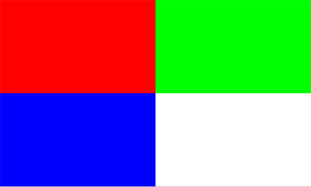

Hi @MM..1 ,
the png you see is just a screen capture of the TouchGFX designer window. All you see was created with boxes and texts were TextAreas.

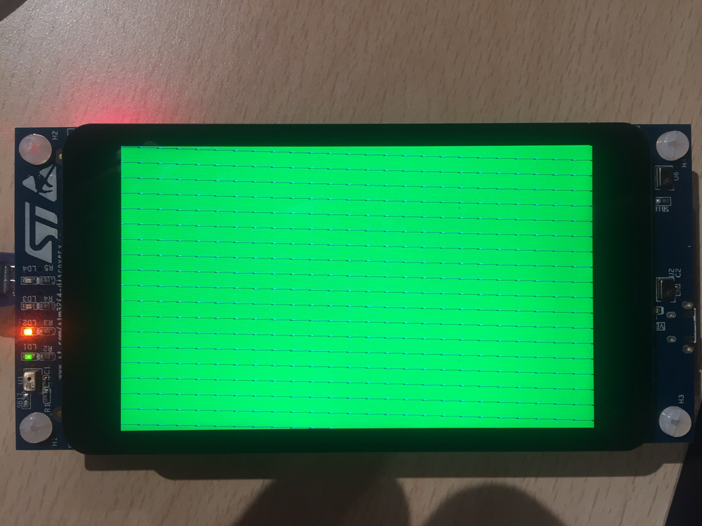

For clearness, this is the screen prepared with touchGFX designer (white line on the left...not very visible):
An this is the result:
